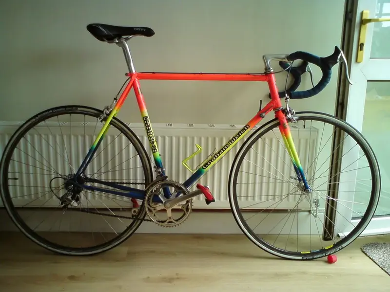

I must be looking in the wrong place as i never saw this one.Presently have a Graham weigh columbus SLX with full Dura ace set and used to ride reynolds frames in the 80's and never got the same ride from the SLX as i find it to uncomfortable.
no wonder that bike was uncomfortable - just look at those forks!!
