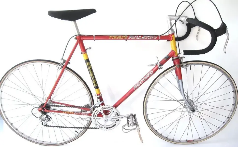

I realise the Team Records were not SBDU bikes and were built at Worksop - but am considering purchasing one and Google has left me confused.

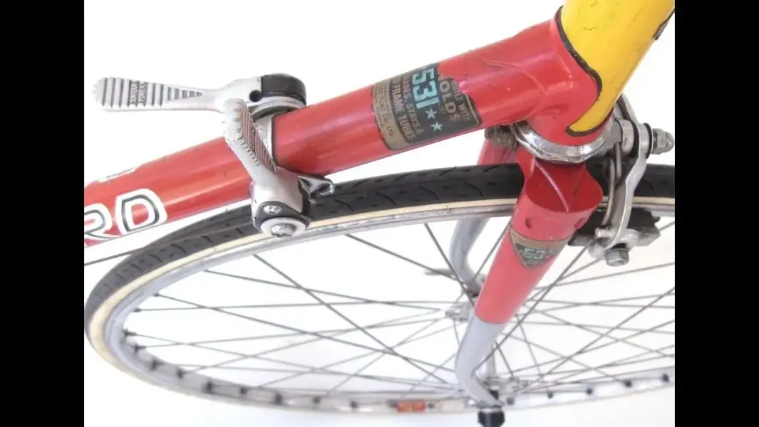

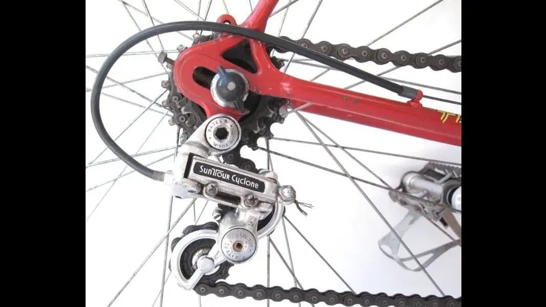

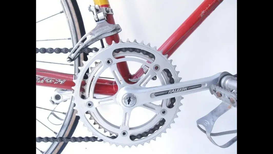

The one I am looking at is original (Suntour cyclone mechs, Raleigh branded chainset and mavic module E rims) is a bit tired (paintwork) but is very straight and has (also original) Reynolds 531 'star' decals indicating main frame, forks and stays are all 531DB. It also has Campagnolo style dropouts (not 'stamped' dropouts I have seen on some Team Records) and has mudguard eyes front and rear. I believe it is a Euro (or specifically French?) specification Team Record?
My confusion stems from the fact that there appear to be very basic 'Team Records' without the niceties I've mentioned above as well as this version.
I'm not deluded - I realise this is not a pro/team/sbdu bike in disguise or anything but given the basic pedigree of a 531DB frame and forks with campy drop-outs etc it looks like it would make a great ride?
(Pic of actual bike added)
Help gratefully received!

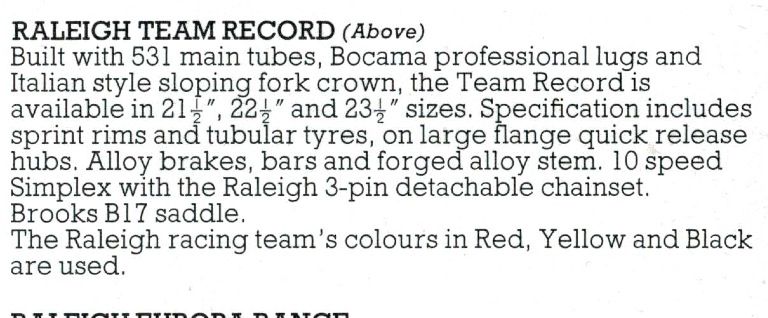

It 'looks' like a Team Record
Although the Reynolds decal is not in it's 'normal' place
1974 Raleigh brochure:
Added some more images of the bike :

No - the pics I've posted are of the actual bike I'm keen on and are from from the seller - who is based in France.
I can only find 'hints' of it on the web but there does seem to be a 'decent spec' French Team Record that was not available elsewhere?
Update - very pleased with the bike as it arrived and the frame number confirms it as a Worksop/Carlton built 531 bike from March 1977.
