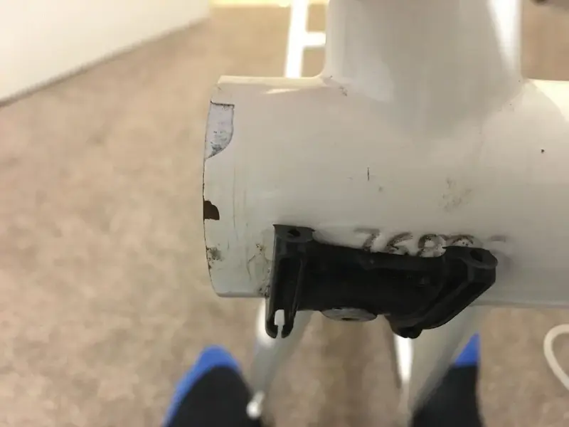

Also the Gipemme dropouts on the fork may help identifying or the frame number on the BB : 76808

Re: Re:
kermitgreenkona88":3sha348j said:
Are there any letters on the serial No. ?
No I haven't seen any number here is a picture:

AndyMart
rBoTM Triple Crown
rBotM Winner
Don't want to burst your bubble but there's not much pointing to Raleigh with that one, frame number, stay caps and braze on's all look wrong. By 87 some frames had Raleigh embossed stay caps and some had small sbdu style stay caps. They did use a similar fork crown but so did other builders (Dawes?). Looks like an older respray to me, those colours have long been popular and desirable.
