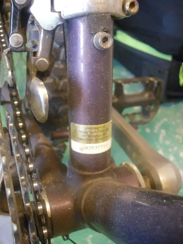

I have a Raleigh Summit 19" MTB which I've had from new, some 19yrs ago. I'm not a biker at all really these days, but I'm looking at trying to breathe a bit of life into my old bike and inspire me to start using it again.
What I'm trying to avoid is buying a new bike as the moneys not there, so thinking of how I can upgrade my existing bike as I still believe it has life in it yet.

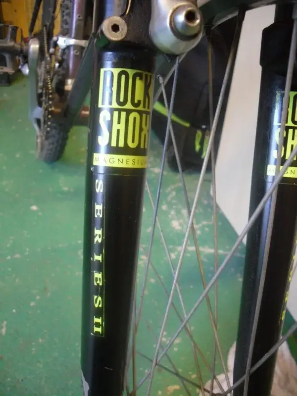

Everything works fine and has been reliable, main problem is the Rock Shox are failing, they don't hold the pressure using the syringe pump tool and also leak oil. I don't know if they are repairable or if its better to just get some new or 2nd hand forks. In which case, which ones are compatible and what do people recommend as I literally have no idea? :?
Also, interested on what people think are other worthy upgrades to improve performance or weight or even the cosmetics.
Specs are:
19" Chrome Allloy Raleigh frame

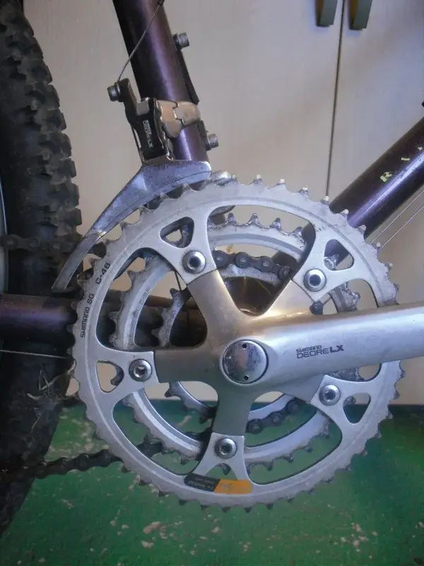

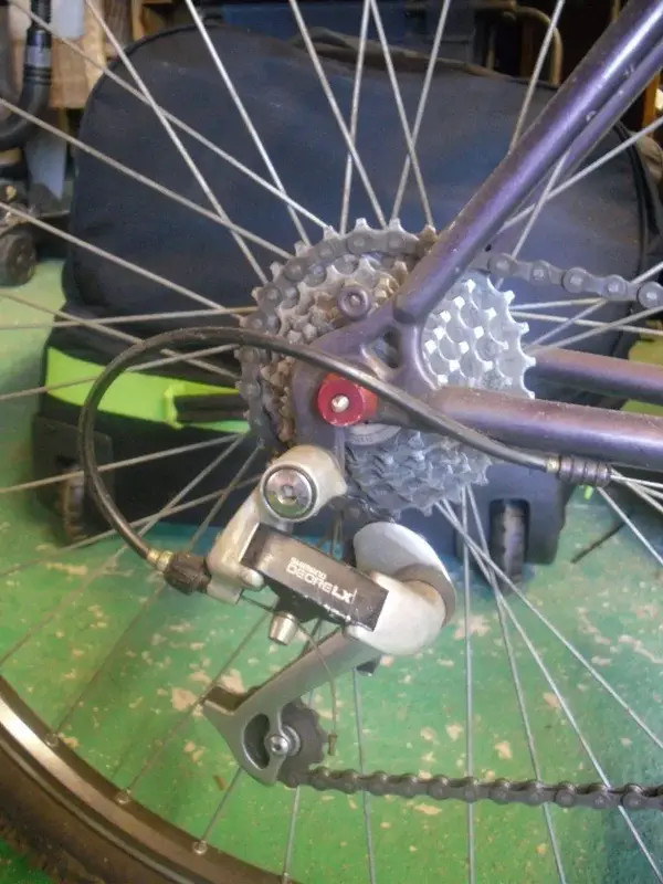

DeoreLX chainset, pedals and arms, front and rear deraleur and hubs.

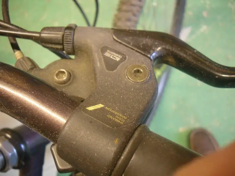

DeoreDX STI SLR brakes/gear shifters
Rock Shox Magnesium Series II forks (air/oil?)

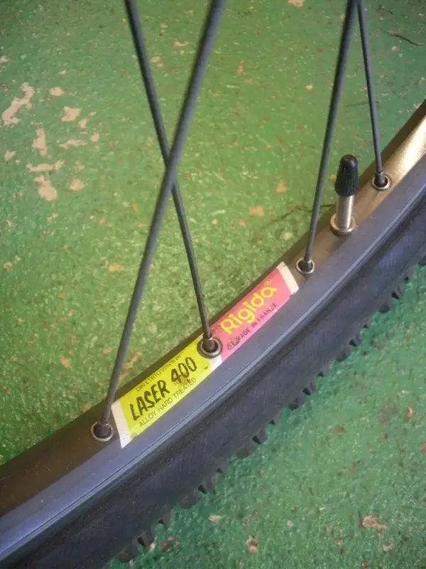

Rigida Laser400 rims
Original tyres
Original Zoom stem
Proponent Seat stem
Onza Bar-ends added and seat recently replaced from Halfords shelf.
Go easy, I know nothing. Pics attached hopefully.

think fork seals are still available for a re-build

If all the parts work (except the forks) there's no real need to change them as it's quite well spec'ed as it is. You should be able to pick up replacement forks for less then £50 so job done. Someone might even be able to fix the one's you've got. Get yourself to the Yorkshire section and introduce yourself.
What's the headset size on these? If it's 1 1/8th you'll have a choice of loads of forks.
I had one of those brand new too :D
The fork manual can be found here:
http://www.enduroforkseals.com/sitebuil ... ervice.pdf
The price to rebuild yours will be prohibitively expensive I would think so swapping the headset to ahead and fitting an aheadset stem will allow you a much wider range of replacement forks. You need to measure the length from where the fork enters the frame (crown) to the centre of the wheel (axle). Comparing your axle-crown height (abbreviated a-c) in most sale adverts here should give you an idea of suitable forks. I'd estimate the a-c on your forks is about 420mm. Your forks are 1 1/8" diametre steerer tube.
A cheap headset is £15ish and you can get a second hand stem for under a tenner here. Forks will be £25-35 I expect - second hand. Labour in a bike shop will be expensive to do the whole lot, so time to make some friends on here!
The rest of the bike looks fine, though changing the cable inners and new brake pads would help restore some performance.

As has been said, just give it a good scrub-up and possibly some new cables although some oil goes a long way! Someone on here will be able to service the forks if you don't fancy it. Suspensionforkspares.com (something like that) if you do :)
