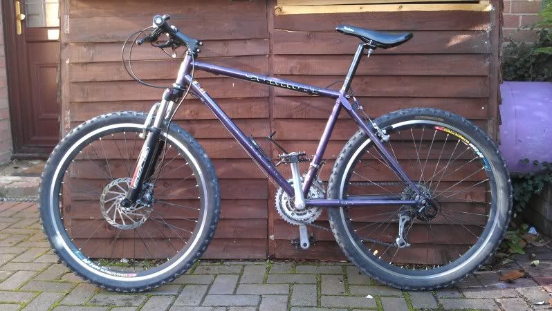

Here is a couple of pics of my summit as it stands at the moment, as said the forks are rubbish and need to be replaced.

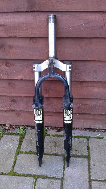

and these are the rock shox:

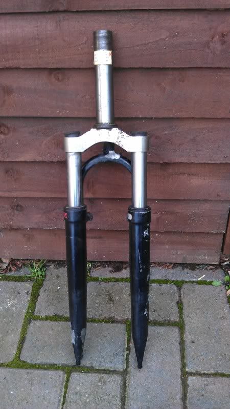

here is the brace with the broken bit, and the other side which is ok,
Travel on those fork is way too long, frame geometry will be well pi**ed.
Same forks I had on my summit with the yellow/green logo. The steerer/crown is on backwards, the forks should be at a slight forward angle compared to your head tube.
I believe any brace from the Mag series will replace your broken one, the later forks had the better/stronger/stiffer braces. I also run a brake booster on the front of my bike as it helps stiffen up the front end.

It rides ok, but I am not as intune with the bike as maybe some of you guys are.
Yes, the fork crown is the wrong way around, I just rebuilt them quick for the pics.
So need to find a brace.
What forks would you suggest that I get, ones with disc mounts?

Indy's are a bit hard to come by now days and they don't come with disc mounts, how would Judy's suit it.
If I kept the travel at 80mm or 100mm, that would be ok wouldn't it?
