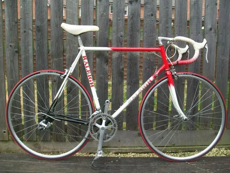

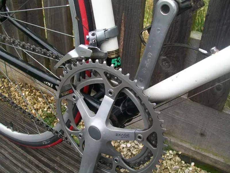

finally found some pictures of what my bike used to look like. It is apparently a Corsa from 1988.
I got my local Giant shop to change the wheels with no fuss so it is back on the road.
This is not my bike, it just looked like this. Still cannot see any other pictures of it anywhere.
Thanks for the update. I have a Strada with that exact running gear. Pretty sure my bike is a 1991/1992 model. I really love the profile of the wheels but I haven't ever seen any others like them, so I'm really trying to look after them.
