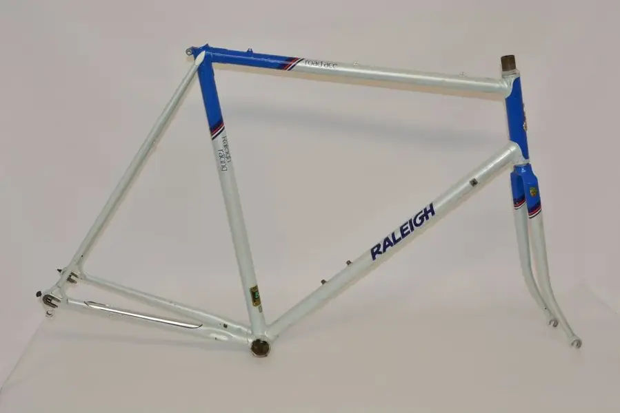

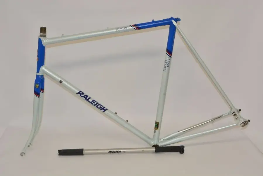

Hi, I've just picked up a 1987 Raleigh Road Ace frame & fork and would like to do a modern build on it.
Does anyone know if I can use a modern 68mm English BB?
Can I also use a standard 1" headset?
Can you use a quill stem with modern bars?
It's my first retro-modern build. Do you think it's a bad idea and I should keep it original? (600ex groupset)?
Thanks for your help!

Hi and welcome to the forum.
Yes to your first two questions, although it might be worth checking the rear dropout width to check you can fit a modern cassette in?.
The last is a bit more of an issue, modern bars tend to have a clamp diameter of 31.8mm and there is not a lot of choice for 1" quill stems that take that size of bar (velo orange do one but it ain't that pretty! :shock: ). So either source some bars with a more traditional diameter of between 25mm and 26mm (ish) and use a 1" quill stem of the right size, or buy a threadless adapter/convertor that fits into the forks and takes the quill diameter up to 1 & 1/8" allowing you to use any modern stem you wish.
Hope this helps and good luck with the build.
Matt

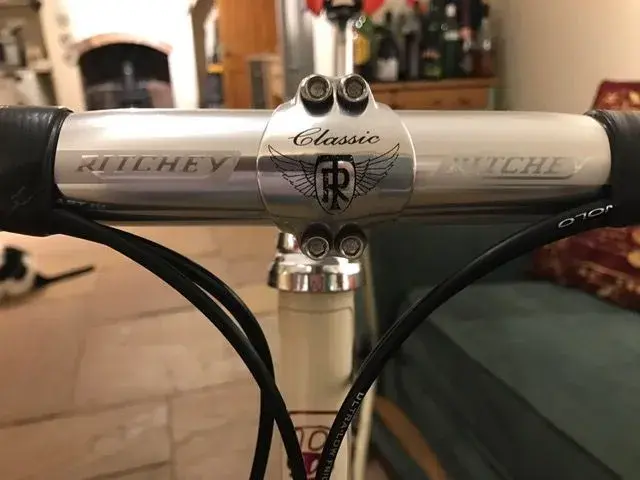

I’ll post mome pics later. Ive got a nice retro mod with quill adaptor and silver Ritchey bars, stem and seatpost. A quill stem does look better if you can get bars with the correct profile for you.
