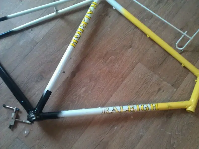

Raleigh ritmo 87 .how rare are ritmos?..Reynolds 531 tubing.1987 built ..in good condition but being restored.here is the frame,it has a small dent on the top tube due handle bars I think and light rust spots as the.paint is very thin on the lightweights.the frame in this picture here was part resprayed.I masked off the decals and part painted it.afterwards I wasn't happy with the fresh paint and the original decals that had few chips on them.so I removed the decals,placed them on a4 paper.photographed them took dimensions and asked a supplier in ebay to reproduce them.which he did.so I fully repainted the frame using the correct colours and applied fresh decals,

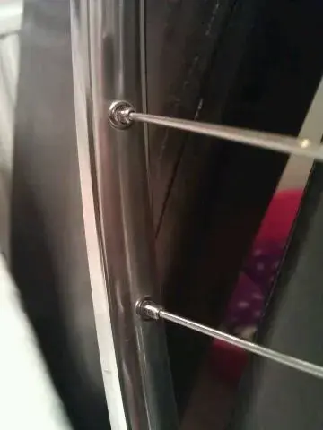

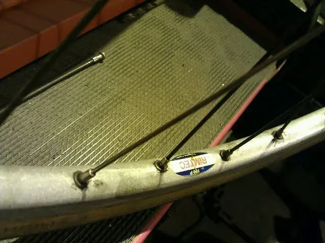

According to the Raleigh catalogue the ritmo comes with weinman wheels.mine had mavics.I believed them to be original so I rebuilt them but I'm not sure if it left the factory with the mavics. years of use,taken apart polished by hand.New stainless steel spokes.New axles cones and bearings.

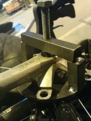

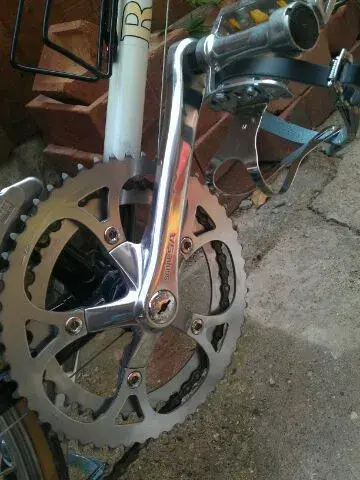

The standard crank puller ripped the threads that the cap uses.the tool wouldn't shift the crank so I made one up in 2 halfs then welded it together around the crank.the crank came off 1st go.second picture is the crank polished and refitted

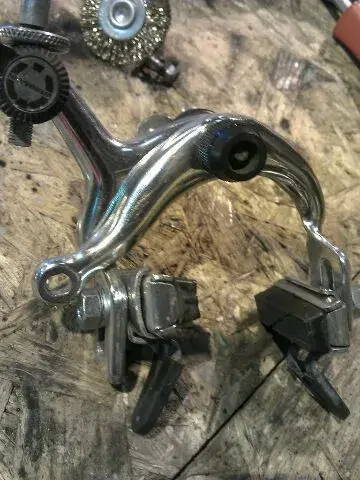

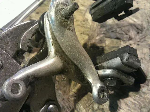

Brake calipers dismantled polished reassembled original brake blocks kept with new nuts and washers.

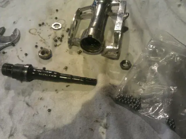

Pedals dismantled.new bearings,and a bit of polishing.
Original regina bx rear sproket dismantled new bearings and grease fitted.

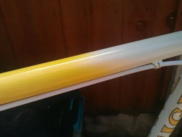

Hi,thanks.the paint fade is just a simple waft with a spray can.spray slow and build the paint where you need a solid colour then just a quick flick to fade it off.it looks a bit pixelated but once you apply top high gloss laquer it will blend itself nicely.keep watching as il add more photos soon thanks.
Close up on paint fade
