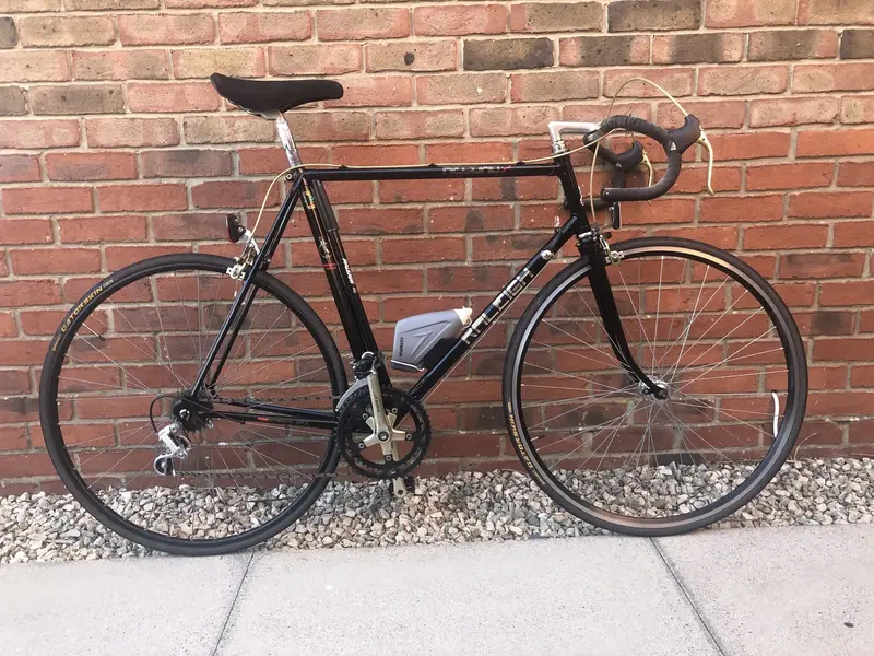

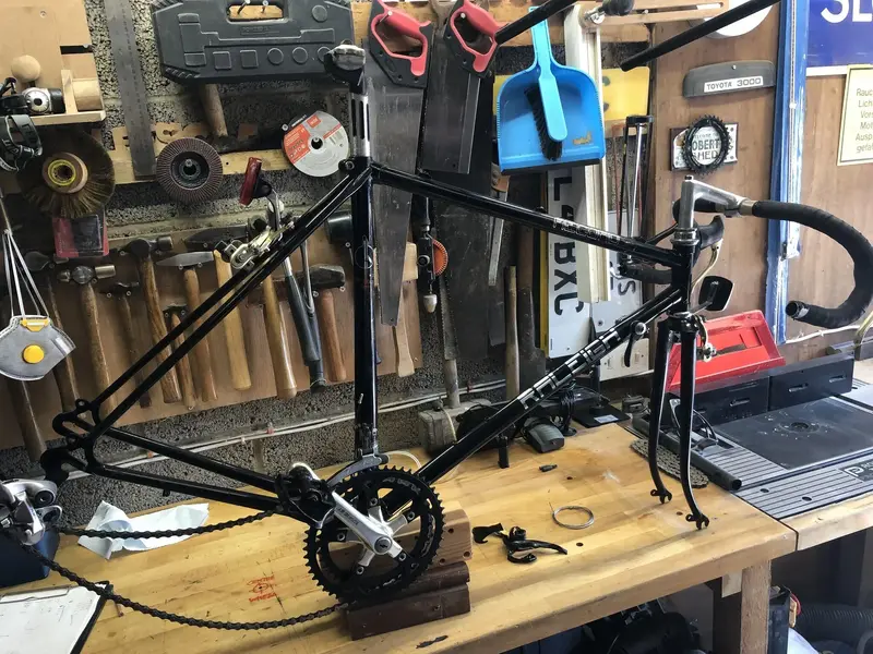

In a fit of nostalgia and a lot of driving, I appear to have purchased two Raleigh record Sprints. I intend to retro build the one I had, the one my brother wrecked for me by dropping a B&D Workmate on it and denting the top and down tubes.
The bigger one (my size) is mint condition, all original but has the wrong rims, the smaller a bit scratched and with some mismatched parts.

The smaller bike has the correct concave rims which I would like to rebuild onto the other hubs.
However, when brand new, were the rims all black or were the braking surfaces exposed?
Anyone got any catalogue images please?

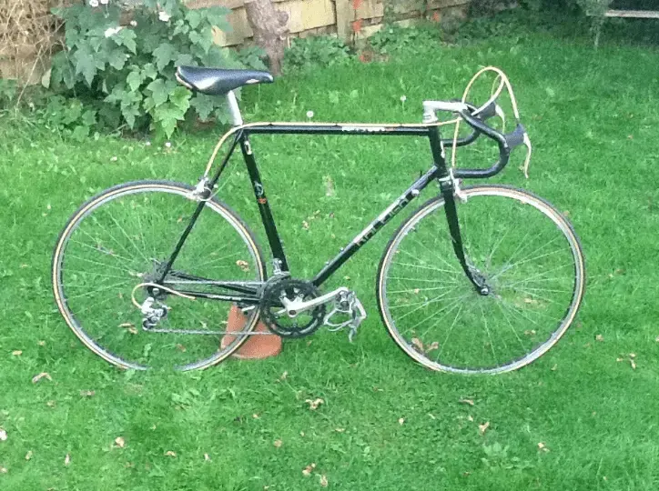

Might be of interest...looks a little rough but has most of its gold bits...esp the wheelset!
Brings back so many fond memories 😍
