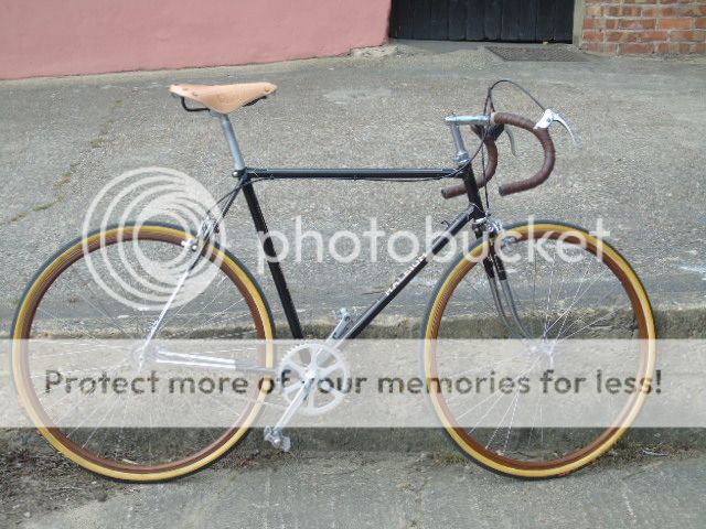

I suppose the question is would they have had hoods back then or would they just of wrapped the bar tape over the body of the lever?
Looks really nice - loving that black and gold!

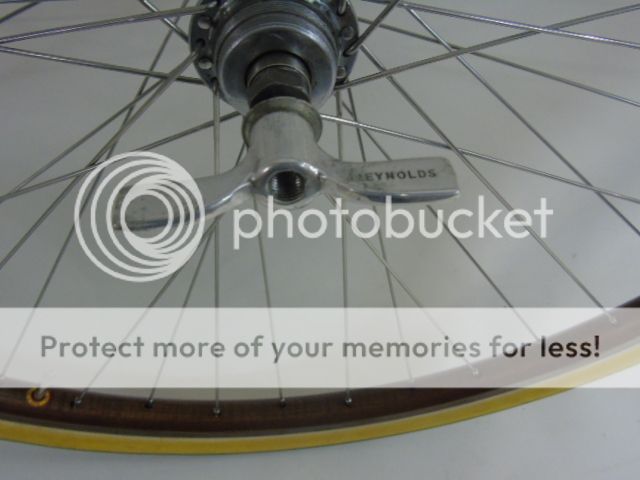

bought a williams crank set today which needs cleaning up but it come with good chainrings (a few as well) and a Renolds Elite chain 1/2"x1/8" NOS.

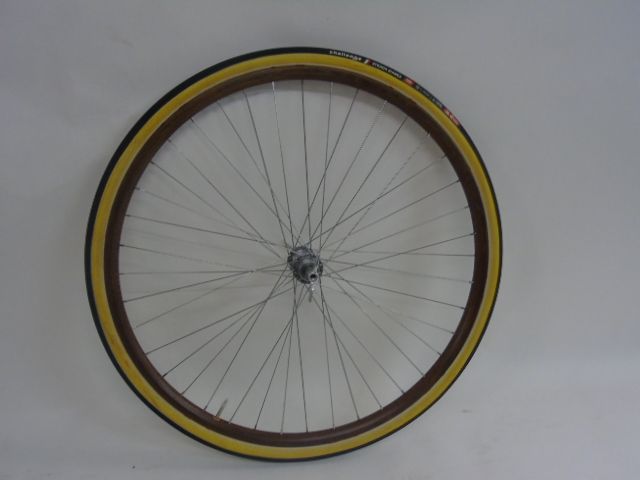

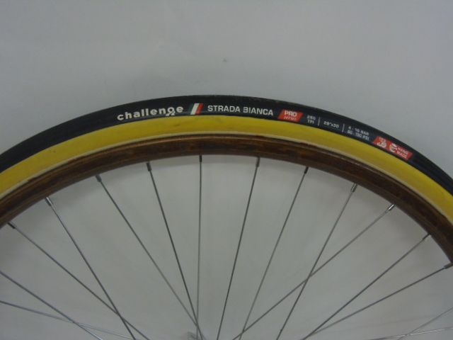

Some progress rear wheel is built tub is now stretching. the wheel is not overly round. I will see how it rides before I try and true it out as it might be O.K. I would have to make some big tension changes to get it round to normal standards so I will just have to see. Brake drop is 60mm which is just right for some very non period correct centre-pull brakes which I will use until I find the right GB brakes or similar.
Progress finally. Tubs glued. Ta chsinset fitted. Sndel cog and kmc chsin run fine. Ronoylds seatpost and brooks b17 selevt saddle fitted. Brakes are rubbish though. I need levers which pull more cable. Any ideas. What is onbthere are gb arret. Once the bike is done (new hoods) and functioning brakes i will do more photos. Generally pleased.
