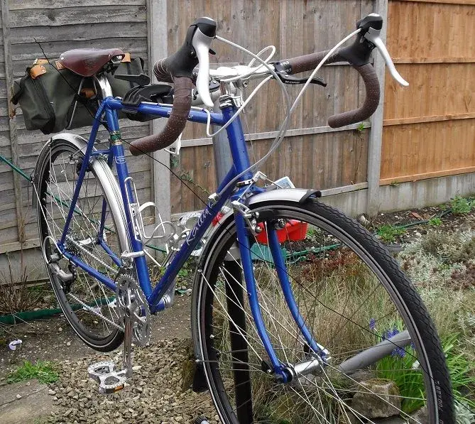

Thread revival with an update:
Been a while since I've had chance to work on the bikes for various reasons, but I think this is now ready to be tried on the road :)
The wheels on the bike are my first attempt at wheel building, I had a wheel set with Quando hubs so I rebuilt with Tiagra and new spokes, and respaced the frame to 130mm.
The chainset is a second hand XD2 triple with some nice big platform pedals.
Looking forward to road testing but rain stopped play just as a finished setting her up today - maybe later.
Here's some pics
