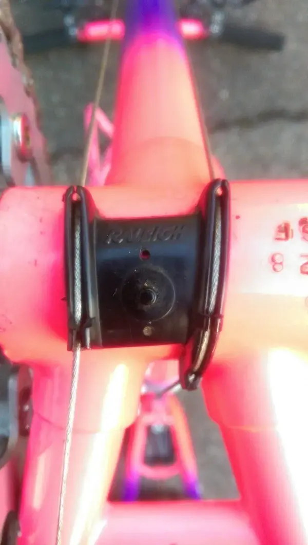

Thanks Nick, I spent some time looking at your one when doing the pre-purchase research, it looks great.Do you know how the bottom bracket cable guide is fixed? Mine is missing....
Sorry it took me so long to reply. It has no screw, just a plastic stud that pops into the hole and prises out with a flat blade screwdriver.
(it is impossible to take a photo of this bike without making it look washed out even though it isn't :D )
Cheers.......Nick

These are the plastic rivet things I was talking about today (not "rivnut" - that's something completely different) for holding the bb cable guide on
http://www.skiffy.com/docs/menufr.cfm?p ... country=uk
They do them for a good range of sizes, based on the diameter of the hole that you're putting it in.
Give Skiffy (Essentra) a call and see if you can get some "samples"...... ;)
EDIT: Just realised the link doesn't go to the page I want it to - search under plastic fixings/rivets/push in rivet

Ahh....I thought that Simon had the cable guide but no plastic "pin" to fix it in place.
Those eBay jobbies look like they'll do the job nicely. :)
