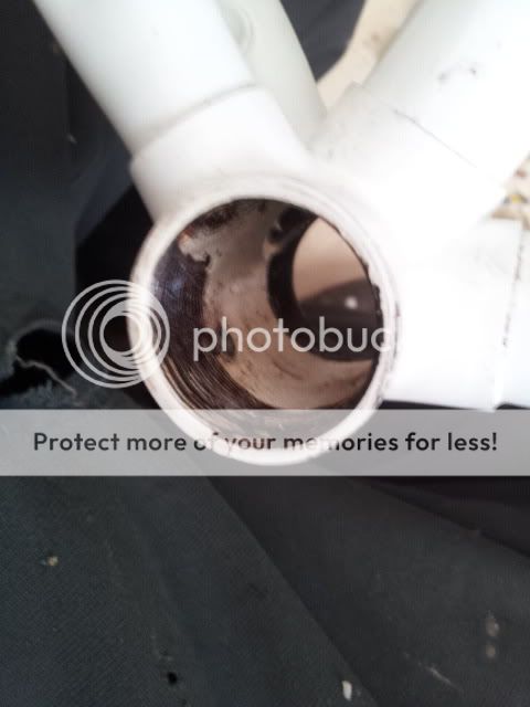

Anyhow as the weather is still frigging awful, I have done a little work on the bike. I ended up taking it to Halfords to get the bottom bracket out and I was getting nowhere and I am glad I did as it took them a fair while with the correct tools. I was using an adjustable wrench that looks pre war.
I was glad to see though that the frame was still solid in there:

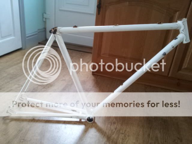

So I continued to give the bike a bit of a clean and it looks okay:
Despite it looking good, I am still going to strip the paint etc and prep it for painting. Instead of doing it myself one of the chaps at Halfords recommended Triple S Powder coating in Bingley so I am going to make sure its solid and then take it into them to get painted (assuming it is as cheap as I was told). I dont know if anyone on here has used them or not?

coming along nicely then! don't forget to remove the crown race from the forks (presuming you're having them p/coated too)
Oh yeah the front forks......I have been spending so long looking at the frame, I forgot they even existed. :oops: Will do them in a bit.
Right, its ready for painting. Its going in tomorrow.
Am having it done in white.

quick tip - make sure you open out / correct the seatpost clamp (and the split in the seat tube) before painting as they tend to get squished on old steel Raleighs :wink:

I will keep the seat post clap apart then. Have been throwing the frame round all morning whilst taking off the paint. Sounds like I was lucky not to damage it.
