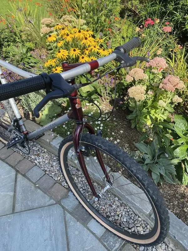

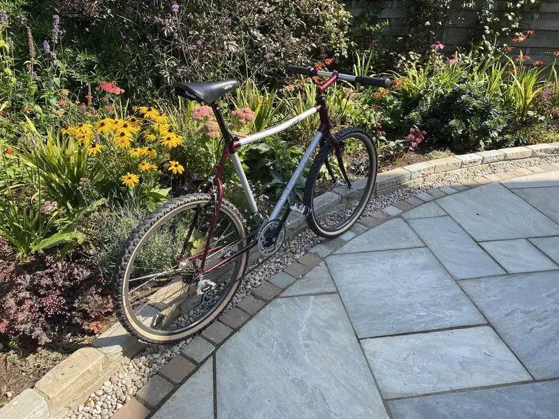

I’ve spent last night and this morning in a state of excitement and anticipation of going to collect this bike. I fully expected to get the “buyer cancelled the sale” type email from eBay as it was a great price for a great bike. It’s happened to me a few times before, this being probably the best bike I’ve bought for a long time. Seller turned out to be a great chap, as soon as I had spoken to him on the phone I could tell the deal would be solid!
I’ve wanted both a Campagnolo equipped MTB and a decent Dyna-Tech for some time so this ticks both boxes.
The bike appears to be mostly original down to the brake blocks and tyres (albeit the tyres aren’t up for a long ride), with the exception of the saddle (came with one of those comfy big bum type jobs have swapped for an old Flite for now) and is missing the Campagnolo shifters/brake levers which have been replaced by early Deore XT, they work but will have to go.
The photos are as I got it, after a clean down with G101, removal of pump peg thingies and reflectors then a quick wd-40 shine, all in all 15 minutes of work.

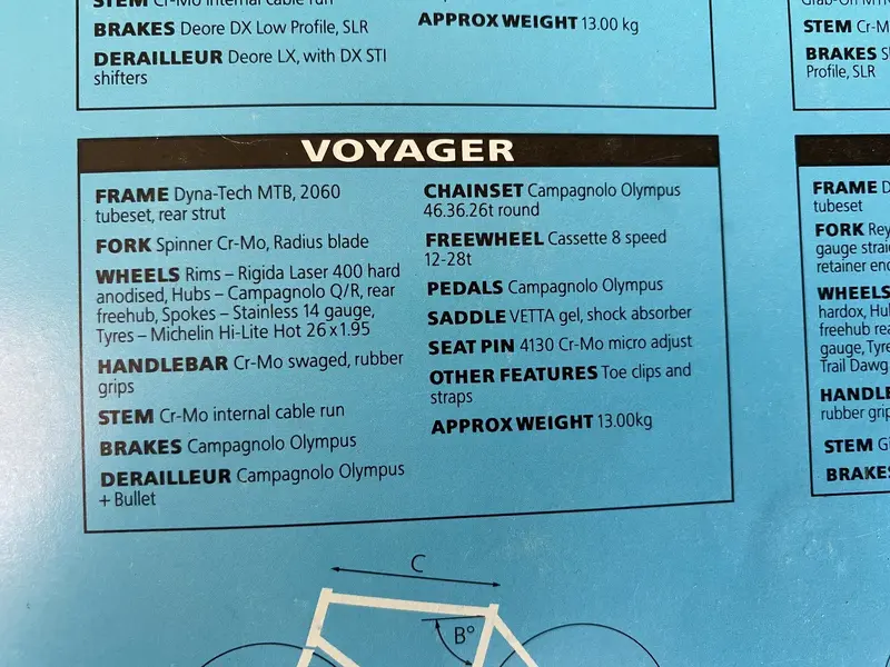

I plan to keep original, find some shifters/levers - if anyone has the correct ones please let me know - Campagnolo Olympus from the catalogue, I’m also looking for 1 pedal dust cap and the crank bolt caps. I do have some Icarus 8 speed bar end shifters I’ve briefly thought about seeing if they can be converted to thumbies.
The seat post has all of the black rubbed off - can anyone recommend how best to sort this - I’m assuming it’s anodised?

Have been working on sorting out some of the bits on this that weren’t quite right…..

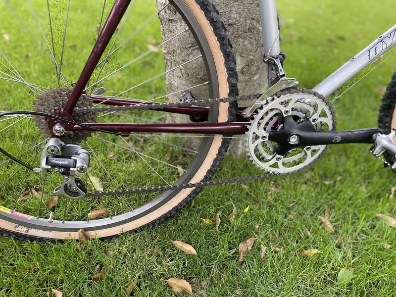

Removed the Deore XT brifters and replaced with the correct Campagnolo bullet shifters and appropriate brake levers.
A couple of issues here - for me they were a complete pain to set up but once I had worked it out I would be able to do it again easily. It remains to be seen how well they perform when actually ridden. Second issue was the brake levers were missing half of a barrel adjuster. I hadn’t noticed this when I bought them as some crafty bugger/clever bodger (delete as appropriate!) had cut half of the adjuster ring off so the partly snapped off thread of the barrel would still screw in. I couldn’t live with this so set about finding another - as I’m sure most of us know finding this sort of part on it’s own can be near impossible sometimes so for now I’ve replaced with a similar looking pair from some old broken Deore LX brifters - not quite as elegant as the Campag ones but you wouldn’t notice unless being really picky! 767BB10F-0727-4B1A-87AF-4E9842E397DD.webp
The seat post I’m really not sure what to do with, it came very scratched with most of the anodising removed. For now I’ve tidied it up and used some aluminium black but it’s not right, I suspect due to it not being the correct aluminium alloy for this product to work effectively. Painting it not really an option as would increase the diameter too much. AF149601-89DF-4862-92F8-D2AE1A3C6998.webp

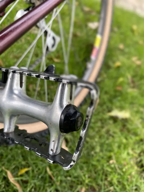

I managed to find the dust caps for the cranks. Still missing one for the pedals so if anyone has a spare or a broken set of pedals! I’ve seen some on eBay but will work out about £40 to buy a pair in order to replace just one.

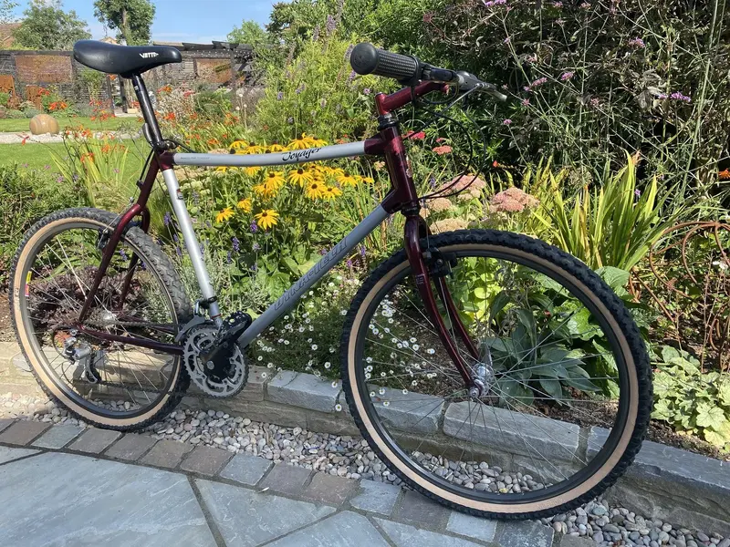

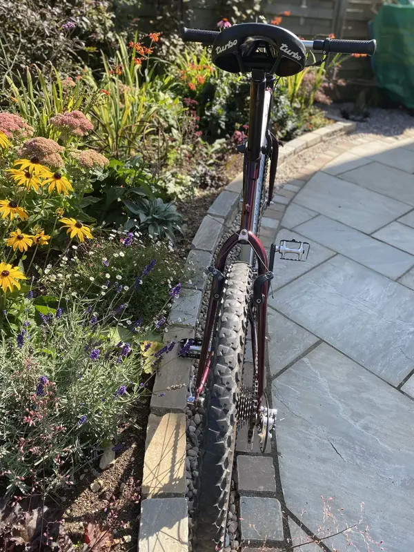

Also found a Vetta Turbo saddle which is much closer to the original than the Flite I had put on there.
Overall really pleased with this, it’s not perfect and nor will it ever be, for me there’s a certain charm about a mostly original survivor. BC167B5C-A41E-437F-84C1-7787D8790DA0.webp E71D1235-BEFC-4747-9972-D1049AAB87AE.webp
Looks great! Good starting point improved massively by the Vetta saddle. Slightly 'larger' saddle designs seem to work well on Dynatechs.
