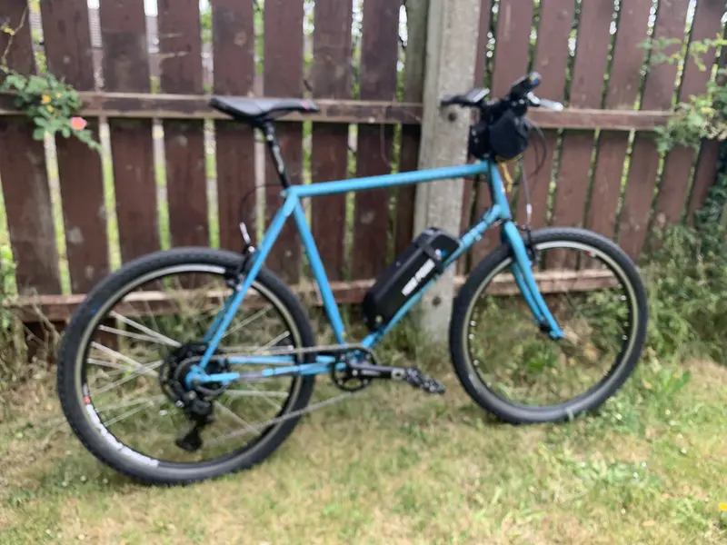

Raleigh dune dancer
How hard/expensive was this to do?
I got the kit from yose power and the basic kit was £350 but the supplies PAS sensor did not fit this bike so I had to add another £12 for a different type of sensor.
Over all it is quite straight forward to do although the supplied instructions are a little vague.
It’s not as neat as a purpose built e-bike as the cables are just zip tied on. But overall I’m very happy with it.
What’s the range and speed?
I bought the uk road legal kit so it has a 250W motor limited to 15.5 mph.
I bought the base kit that has the smallest battery but I don’t know the range as I have not taken it out for any long rides yet.
