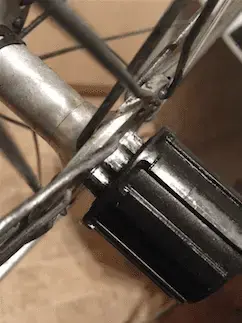

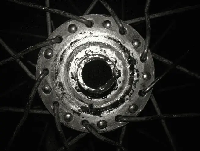

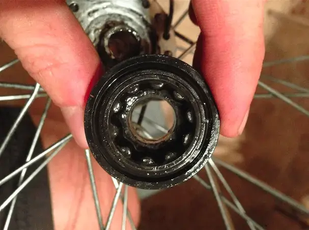

So I ordered the cassette and freehub. They both fit together which is great, but i’ve got a couple of problems…. (see images attached)
1. I’ve tried to put the free hub onto my rear wheel hub, and it doesn’t seem to fit, but it looks like it should do…! I’ve managed to get it on mostly (I think!) but it doesn’t seem to go all the way down. Have I bought the wrong fitting?
2. With the hub mostly on, I fitted it all back together, and it looks like the axle is now massively too short. The cone nut screws on, but the washer, and final bolt won’t go on, it looks to be about 10mm to short!
Do I need a new axle, or am I doing something massively wrong?

The freehub should push onto the hub and locate into it before you screw the 10mm allen key inside in..
It looks like this hasn't happened
