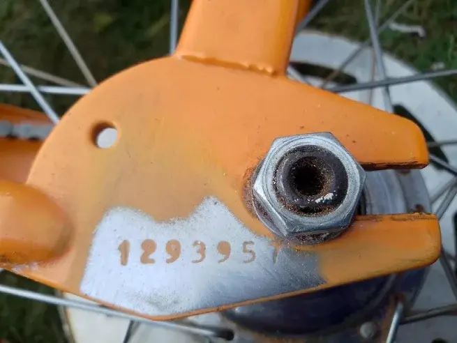

This is the serial number of my Mk1 Raleigh Chopper.....anyone out there that knows what year and month it is.....or even better explain the numbers to me....cheers
