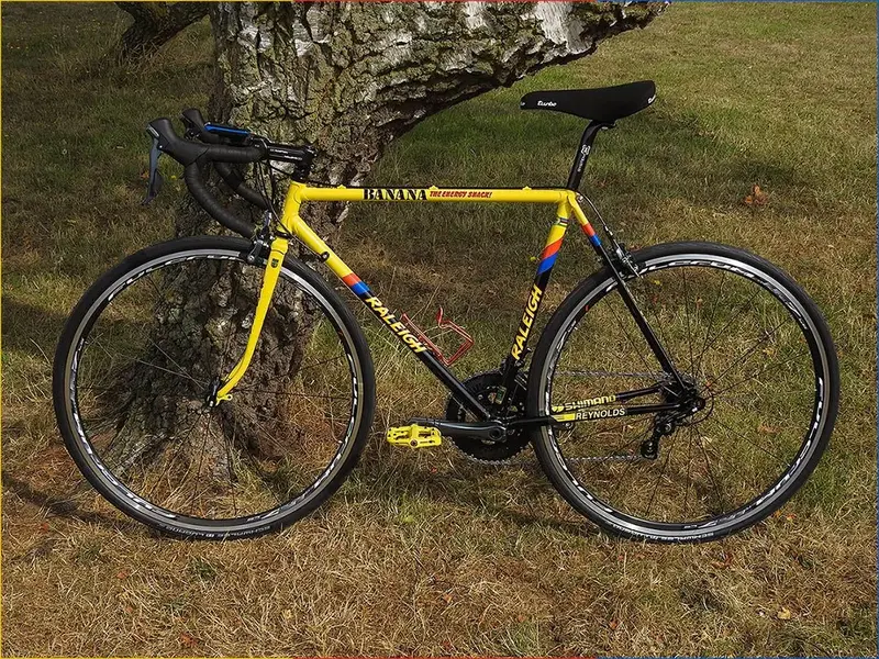

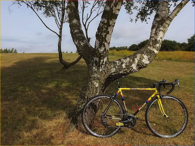

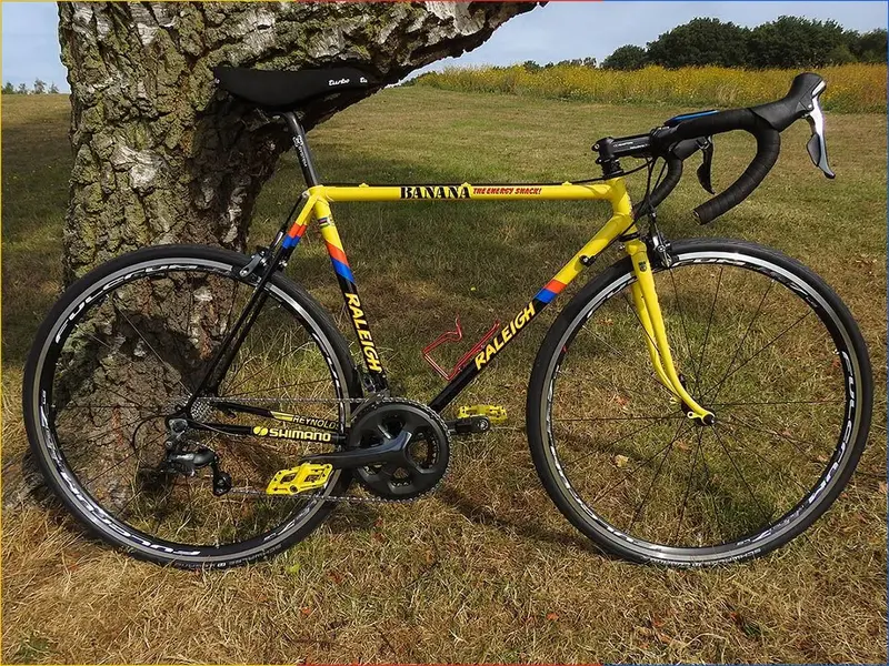

So yesterday I finished my final few jobs on the Banana and it was complete, today, I took her to a local park for a bit of a photo shoot and to take some video as she will never be as clean again as she is today.
I rode her about, 1.5 miles each way, how did she ride? … Awesome! First thing I noticed was some pain in right hand on bars, not sure why but these bars are not as comfortable as my other aero ones. Next thing I noticed was just how comfortable the overall position was and the seat too, but not only that, the bike rides in stealth mode, it’s totally silent! No noise from the tyres on the road and the free hub is schhh quiet.
I am into these 28mm tyres now in a big way and going to see if a set will fit on my Cannondale CAAD 12.
I also noticed the lack of the 28t rear cassette and the 25t being quite a lot harder.

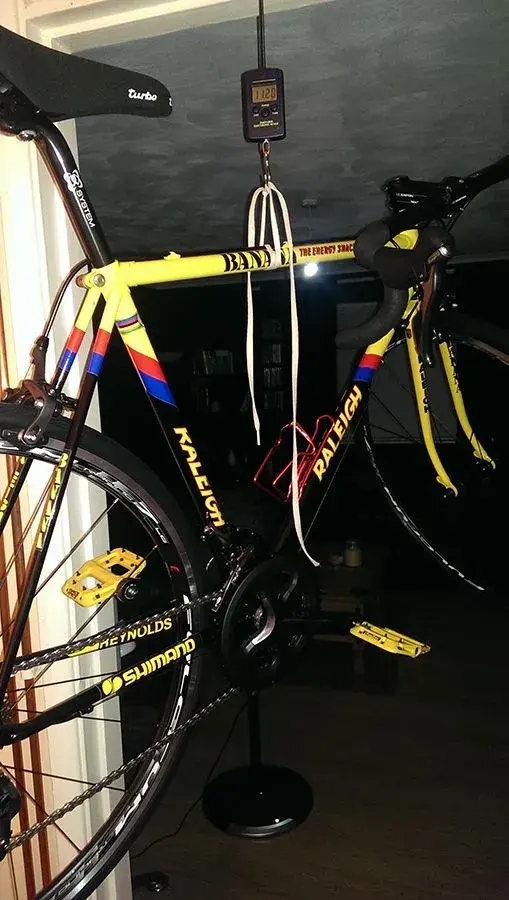

Weight …. She’s a heavy beast tipping the scales at 11.2kg :facepalm: (exactly 1kg lighter than standard – 12.2kg) just bike and 1 bottle cage, when you start adding garmin and mounts ya looking maybe 11.5kg, add an additional water bottle cage, an extra bottle, under seat tool bag and top tube food bag and I think she is going to roll around the 13kg mark :l
I was a little disappointed in this and I really hoped I would get her down to the 10kg but this hasn’t happened, still despite the ballast when she’s rolling I honestly didn’t notice, I think you will notice more when starting from a stand still and of course any long climbs, but if it’s straight or down hill, she's fine :lol:
I need to take her on a proper ride to get a real feel for what she’s like, but first impressions are,… Awesome! 8)

Cheers everyone, now for what you all been waiting for, some pics and some VIDEO (excuse the song I needed sommat 80’s to go with it).
[youtube]https://www.youtube.com/watch?v=pgCKiL9SXW4[/youtube]
Had to reduce size and quality of images to be able to upload:
Final data, component list, weights and cost:
NEW Build - Raleigh Banana
Weight Cost
Cost of bike - - £55.00
Powder Coat - - £60.00
Raleigh Decals - - £29.50
Spray Paint (black) - - £7.14
Frame (Paint + decals complete) 2,365 - -
Forks (Paint + decals complete) 827 - -
Tour Decal - - £4.95
531 Decals - - £10.50
2 x Lacquer - - £27.60
Brand-X Road Racing Bars - Compact. 42cm, 31.8mm, 90mm Reach 125mm Drop 334 £16.98
Headset - Tange Seiki Falcon FL250C 1 Inch Threaded - Black 85 £22.99
PZ Racing Quill to Ahead Stem Adapter 169 £12.95
Bar Tape 45 £4.99
Selle Italia Turbo 1980 Saddle Black Nubuck 301 £21.00
System EX Seatpost 25.4 317 £12.99
GUB 05 74mm Bottle Cage 46 £3.60
Bottle Cage Bolts x 2 6 - -
Shimano Tiagra 4700 10 spd Crank 172.5mm 52.36t 965 £205.99
Shimano Tiagra 4700 STI 10 spd Shifter + Wire (L) 259 - -
Shimano Tiagra 4700 STI 10 spd Shifter + Wire (R) 267 - -
Planet X Braze On Clamp (28.6mm) 27 £4.99
LifeLine Essential Gear Cable Set 190 £3.99
Shimano Tiagra Short Cage Rear Derailleur 11-25t 257 - -
Shimano Tiagra Front Derailleur 2 x 10 spd 92 - -
Shimano Tiagra Duel Pivot Brake Caliper Front (converted) 183 - -
Jtek Tektro / Shimano 70mm Dual Pivot Brake Bolt Nut Conversion (inc. above) - - £6.99
Shimano Tiagra Duel Pivot Brake Caliper Rear 195 - -
Nyloc Nut (x 2) (weight already included) - - £1.99
Dia Comp DC56 (2 x F) DC58 (1 x R) 1/2 Moon Washer (weight included) - - £2.25
LifeLine Essential Brake Cable Set 90 £3.99
Shimano HG Cassette 10 spd (253g - 258g with spacer) 258 - -
KMC 10 Speed Chain Connector 1 £4.99
Shimano Ultegra 6701 10 spd Chain 255 - -
Race Face Chester Composite Flat Pedal 362 £41.99
Fulcrum Racing 7 LG 2018 - 100mm Front 845 £114.99
Fulcrum Racing QR Front 62 - -
Fulcrum Racing 7 LG 2018 - 130mm Rear inc. Shimano Freehub 1,050 - -
Fulcrum Racing QR Rear 65 - -
Schwalbe Lugano Bike Tyre - K-Guard - 700c x 28x 431 £10.99
Schwalbe Road Tube - Front 40mm Valve - Presta - 18-28c 107 £3.99
Schwalbe Road Tube - Rear 40mm Valve - Presta - 18-28c 107 £3.99
Shimano Tiagra 4700 Bottom Bracket 89 - -
Downshifter Converters - Cable Stops 23 £12.95
Rear Derailleur Conversion Hanger 33 £2.99
Bottom Bracket Gear Cable Guide 6 £2.09
Cable Ferrules - - £1.50
Total 11,197g £735.44
Any Q's on this build fire away, happy to help 8)
