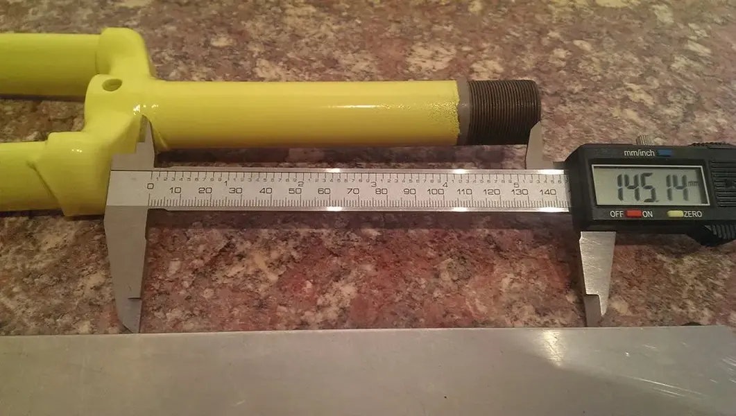

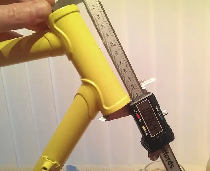

OK lets get the digital calipers out and get some real figures in...
So we have 145mm steerer minus 110mm headtube = 35mm stack height?
If that is to be the case then I need a 1" threaded headset with a 35mm stack height?

Yeah I reckon you need a 35mm stack 1" threaded headset. Your calipers aren't quite parallel to the headtube in your photo, which would give a distorted reading, but I know what it's like doing three handed photography with two hands.. :)
