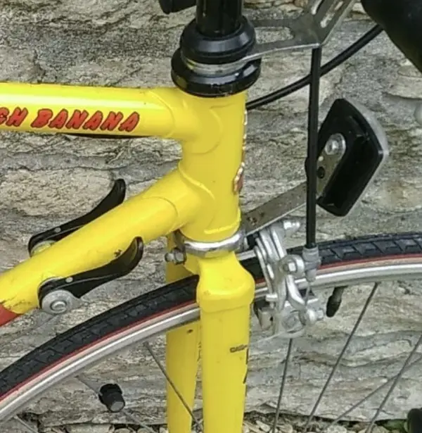

Welcome to the Forum. I think the answer most of the questions depends what you are looking to do with it, but if you’re thinking of keeping it as original as possible (which it sounds like), you just need to replace the freewheel with another 6 speed one, compatibility is not really an issue if you stick to 6 speed.
Replacing the brakes is a good idea, though, as the original ones are pretty poor. I doubt the Veloce ones will fit unfortunately, because the frame is designed for ‘nutted’ brakes, not ‘recessed nut’ ones (which nearly all more recent ones are). Tektro do make some which would fit, specifically to solve this issue.
Good eyes spotting the external nutted brake mounting; but I believe that is an indicator that the calipers have been changed. Pretty sure the frame was designed for recessed nuts. I do not have any Raleighs that new to compare (newest is an '84ish Marathon?). I would take a look at other frame examples of that bike and directly compare how the brakes are mounted; think they would be recessed. Also, that front brake seems odd having the threaded stud sticking out that far. Regardless, someone mentioned Tektros as a good option (and price); I agree with that.

The brakes are definitely not for recessed nuts, which for cheaper bikes like this was usually the case. The bolts are sticking out a bit more than normal because they originally would have had reflectors.
