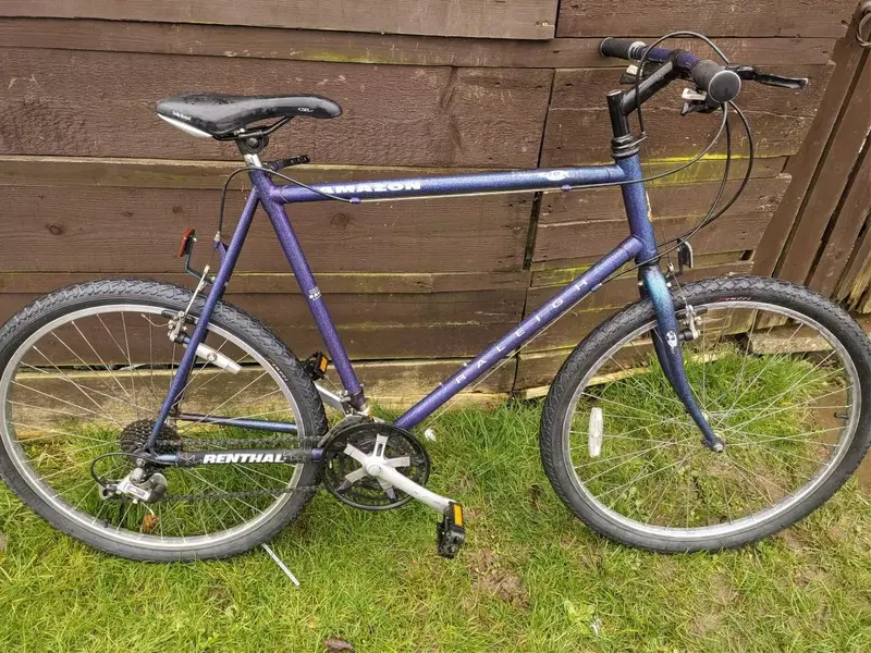

Thank you it's a great bike rides like a new bike it's my daily commuter I prefer it better than my modern bike it's more enjoyable and looks better than modern Raleigh's latest update I've changed the original tyres it's now running 26x2.10 road tyres and obviously lock on grips it's getting there slowly
Forgot to add image to my previous post here's what it looks like now new tyres and grips

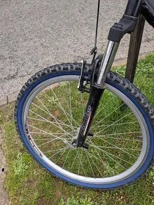

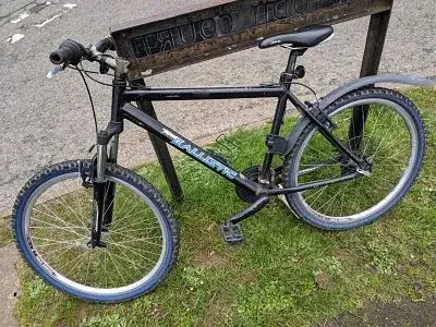

Morning all picked this bike up yesterday as a parts bike for the Raleigh Amazon has the shimano alivio group set and revoshift gears 21 speed, would anyone know if the suspension would fit the Raleigh??
