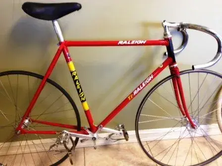

But here is another frame that's supposed to be associated with an old Raleigh team member,
I'm confused but it all sounds exciting.

I'm slightly irritated by the mystery...what is the problem with just stating who the frame is supposed to be linked to?
Rk.
Cause I don't no just yet, but as soon as I find out you'll be the first to know, :D
I assume that the track bike above is currently owned by the same person (judging by the wall paint colour!)?
It's almost identical to mine, but is that a 753 sticker on it? Mine is 531. So there may be an interesting story to follow.
I agree with most of the posts above re the road frame. However, I also have a Raleigh Ti Professional from 1983 (non-SBDU built), which has the later fork crown, as per your photograph. So if this frame is from 1982/3, which given your frame number, it is, then the fork could possibly be correct.
Edited to correct details and dates.
Looking forward to knowing which professional rider of the early eighties riding for the TI-Raleigh team you are on about, and also the story behind the fact that his team bike(s) do not have the team rider stamping.
Could it be a spare bike that just sat on the team car in case it was needed?
