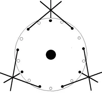

crow pics

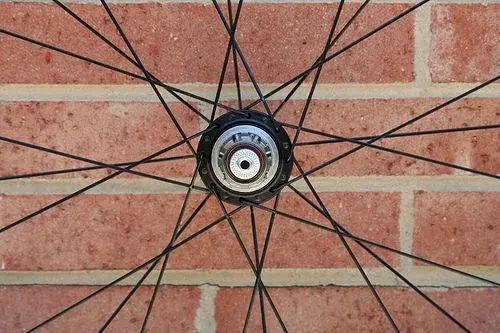

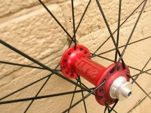

Pretty slick. I haven't done one in a while now, so these pictures are from the web.
