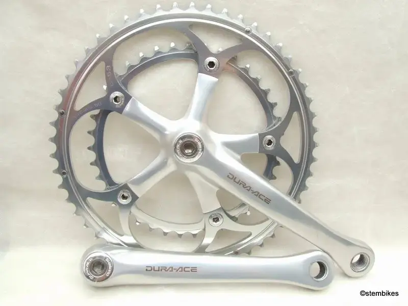

ebay link to 175mm 7410 cranks but with non original later chain rings , this is what the originals looked like with Shimanos first lifting pins and the "channel" around the perimeter . http://www.ebay.com.au/itm/Shimano-Chai ... 41710c1c25
I have some dual pivot brake calipers if you want to do a swap to later ones.
