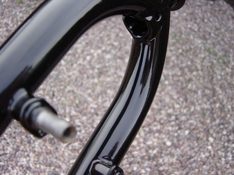

I filled with metal as it won't shrink with age (some body shop style fillers will) and it guaranteed a good result with powder coating. This was especially important to me as it was getting finished in gloss black.
The repair is under the thin black line slightly off center to the left of the centreline :
Even knowing where the repairs are, they are completely undetectable by eye when checking the curves / reflections etc :D
WD :D
