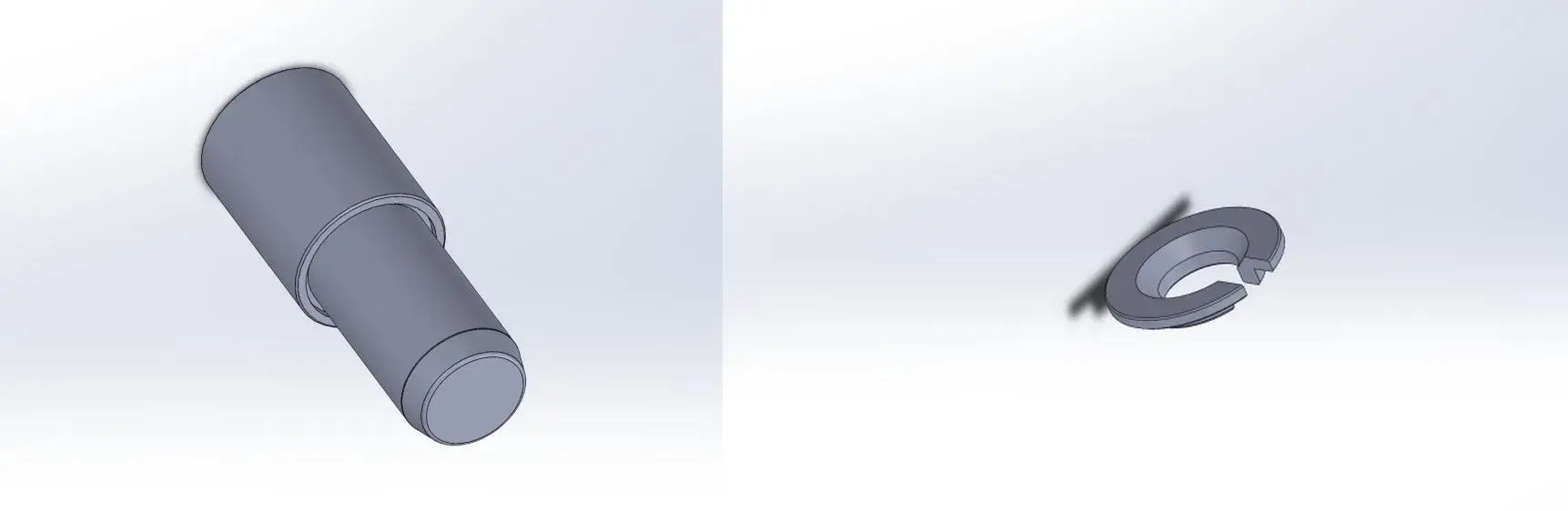

O.k., I will go for it. I played around with CAD, by being a little 'rosty' I needed some time to created the models to be able to make drawings.
I also found some nice guys who will produce the first samples.
I think I will offer bundles which includes Bomber seal kit AND tools. The bundled tools will be a 'cheap version' just to cover the costs - I think this makes sense, but we'll see :-)
They look great. The Unior one is recessed so I think it can be used to install the dust seals, but I just fit them by hand last time. I followed the manual and it only says to fit the oil seal with the tool.

Not a hero thing. I thought also about this. From the XC series dust seal insertion I know it can be pressed in by hand. But the Bomber seals are much more hard to press in and out, if you lose verticality during inserting you will hurt the seals with it's metal sceleton for sure. I know the advanced mechanicans under us can handle, but one servicing a fork one time every 5 years might be happy about such tools which helps in this case.
So most im important is the oil seal insertion tool, but I will test also the dust seal before we go.
