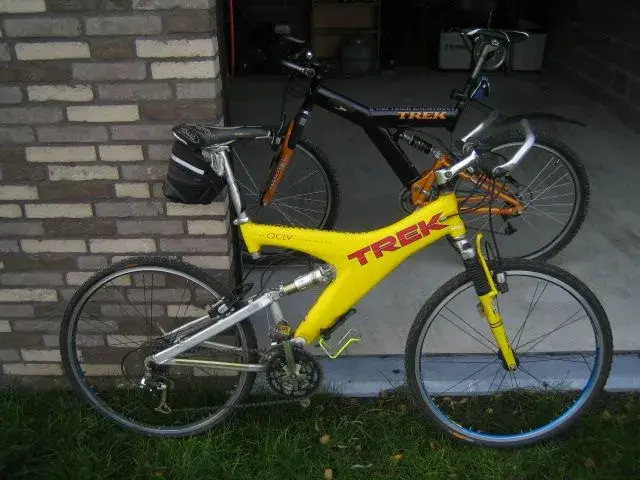

Ok So be it...
My bike is still original and i'm happy with it!
