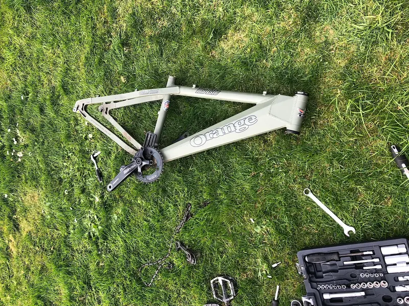

Never rebuilt a bike before so today I decided to break it down and start the process.
Everything is off except the crank and bottom bracket. No matter how much force I use it will not budge. I think I need a professional in that area. That can be done after lockdown is over.

To get the cranks off, are you using a crank puller/tool or simply trying to prise them off with the bolts removed?
