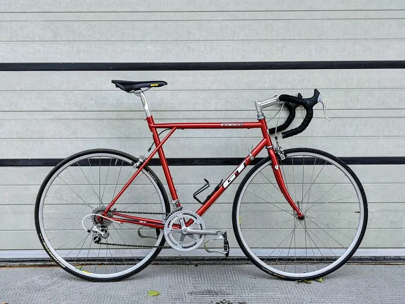

Almost three decades later I bought myself a GT Tequesta 1997 for offroading with my kids...and two days ago a GT Force (I guess its from 1994) for EUR 300. All components are original (except of the rear tire), full Shimano RX100 and steel frame.
It hasn't been ridden much and condition of the bike is, imho, almost mint.

Now here is my dilemma:
I'm aware that the GT Force is not as desirable as a GT Edge but the condition is extremely good and I think that I might have a trusty and soulful bike by changing the following components:
1. Tires (Continental GP5000, 28mm front, 25mm rear)
2. Handlebar and stem (shorter stem and handlebar with modern geometry)
3. Shifters and maybe brake caliber
4. SPD pedals
5. Modern wheels (optional)
What would you guys do? There are two options for me:
1. Clean it up, keep it original, hang it on the wall and adore the aesthetics (potential investment?)
2. Change it and ride it
Thanks for your time

I think that's a really good looking bike and I'd be happy to ride it as it is. The pedals are just a technique which you'll pick up and in my opinion are less risky in traffic than SPDs - when I had straps I used to ride in town with the kerbside strap loose enough to easily pull my foot out.
I'd change the stem to suit a comfortable position and replace the brake blocks with something more modern - they do harden with age, I recently changed a set of mine after noticing that the braking on a bike with much newer but cheaper calipers was way better than that I had on my better but older bike.
I agree with Jim. Fit new blocks (with replaceable pads), lubricate the brake cables and I'm sure braking will improve dramatically.
GP5000s are wonderful fast tyres, but not something for a wet winter. 100km on dirty wet roads and you stand a real chance of destroying a tyre (how do I know this? :(). Conti GP4Seasons or Michelin Pro4 Endurance would be my choice - with the 5000s in the summer. (Disregard if you live in Spain or Italy).
I would make it fit me by changing bar and stem, swap the brake blocks / tyres and ride it.
Road bike geometry has not changed much if at all, and they don't make steel framesets like that any more without going custom.
Lighter modern wheels may be a nice upgrade but be sure to get something that looks right.
300 euro is not an expensive bike these days and don't be deluded into thinking its an investment.
