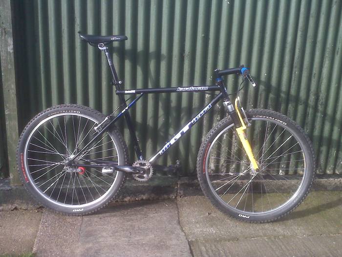

can you post a pic of your karakoram? would love to see it
can't wait to share the pics of the RTS from the shed now... :lol:
Here's my 1994 Karakoram (yes, it has a chain fitted now!). I've got a 1996 RTS-2 too, lovely bikes arent they :wink:

think your stuck with the U brake on the back but a V on the front would be a life saving upgrade perhaps ,it the rest of it works leave it alone and
enjoy the old/nice bike feel

Gents - they are sweet rides. never imagined others would love their karakoram's as much; well to be honest even more.
love the clean-ness of the frames - wish i hadn't gone a little OTT with the stickers..

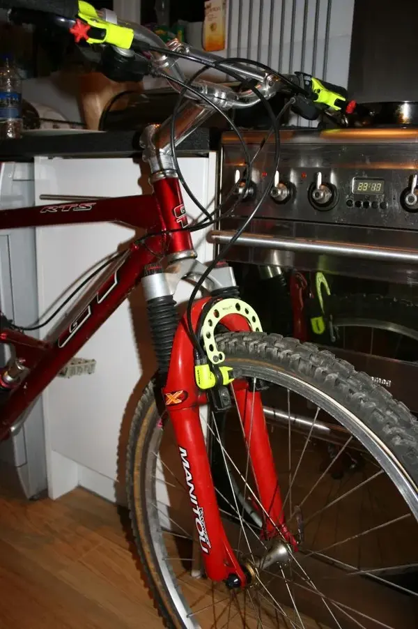

Can't decide whether to take on the RTS rebuild - heavy bike - also kept bottoming out at the rear which made it v difficult to ride.
Could i import some of the parts across to the karakoram? could save me some $$$$
Time to share the RST
rts

I Shouldnt think it'd be too hard to source a replacement stay, or complete rear triangle even, on here
Indeed.
Browse the FS section or try a wanted advert.
thanks for the help
have any thoughts on my other questions?
do i need to know what model RST i have before i find a replacement stay?
would really appreciate understanding how you approached your RST refurb.
there were two types of rear triangle, early steel ones and later alu ones
yours appears to be an alu one
