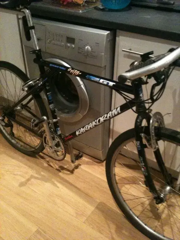

1992...It's got the Groove Tube top tube which was introduced in '92 and the True Temper GTX tubing. It's also the last year GT had the model name on the down tube. Starting in '93 they went to the "all GT terra" on the down tube.

I'd tidy that up, but dont 'upgrade' to modern parts, keep it all original. If you need to replace anything you'll easily find period correct parts on here.
Do what mikee says, buy a hack for the city and keep the GT sweet.

Any thoughts on what sort of shocks i could put on the front? it's a threaded headset - probably 1" but i don't know. Headset is shot, hence the thought of converting and upgrading the forks
the frame could also do with a re-spray - lots of loving scratches and wear/tear. difficult thing to do?
Pretty sure forks steerer tube is 1 1/8 inch. If you looking for correct period suspension, Rock Shox mag 20/21 will be the best probably . Otherwise nothing with long travel, around 60 mm max as these frames weren't designed for long travel suspension.

Please dont put 'new' kit on it. Replace with period parts, but you can find new old stuff on here :wink:
Rock Shox suit GT's perfectly, some Mag21's or cheaper Quadra 21's/Indy S or SL. Bear in mind that if you were to consider putting modern suspension forks on a older frame, with most being longer travel you will mess the geometry up (ie higher front end) and effect the handling.

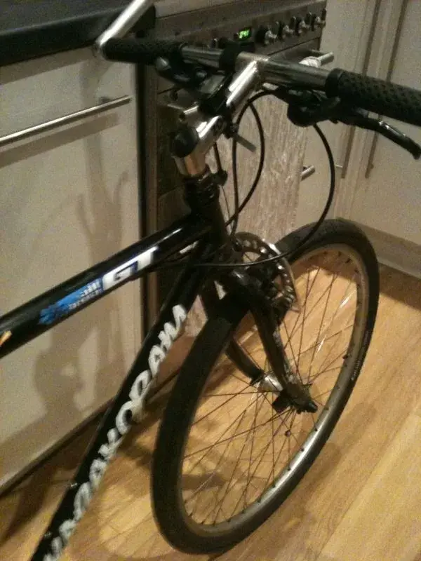

Headset is 1" 1/8th. On here you can easily find threaded or ahead forks, plus if your headset is shot you may consider switching to ahead. My 1994 Karakoram is 1" 1/8th ahead, and is wearing Rock Shox Quadra 21's.
excuse my idiocy - what's an ahead headset?
don't want to mess up the geometry
can you post a pic of your karakoram? would love to see it
