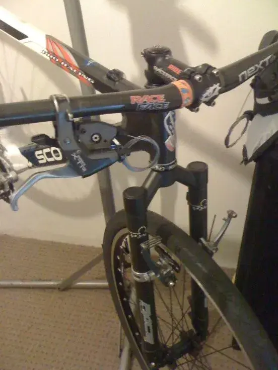

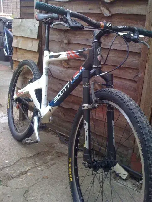

I got this frame from singletrack about new year with intention of building as road winter trainer. But by the time i got round to building it it was spring and thought i could singlespeed it with bits from the shed, which is after all the point of singlespeeds! So heres my beauty! 22lb
was thinking of convertering to a single ring at the front and 9 at the back for the winter. Or maybe i should just polish her and put her in a glass case!!!
I've never seen the appeal of garage queen bikes, I prefer to ride them than look at them.
How do you find the ride? I think its the best bike I've owned by far, and is a positive encouragement to go out and ride.

its very smooth to ride, you cant feel the rear flexing but that maybe the flex! Climbs extremly well. ive had two now, first one had pace sus forks but was too big for me adn so got the smaller one. Good descision.
