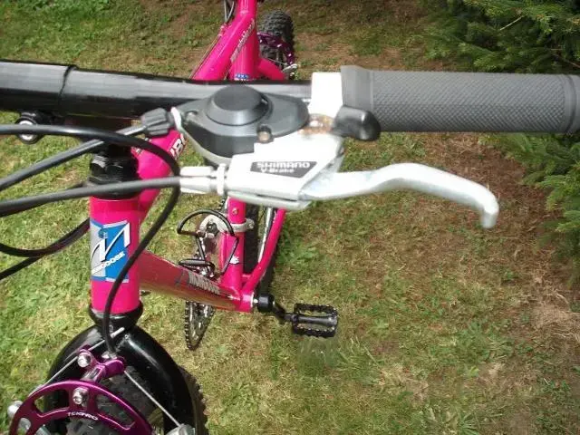

tinker":z98na85r said:
The booster is there for one reason, becouse im using cantys i deedid somthing to mount a cable hanger to, other wise the front brakes will not work, it will simply compress your forks,
basicly it is there as a cable hanger thats all. but trying to find or fab somthing
that i could use to hang the cable off was not easy and if i did find or fab sumthing that would serve this perpous it would look Horrible, that is y the brakes are being chainged to xtr vs, and the booster is going on the back brakes,
Tinker
The Red/Orange booster on the pics doesnt appear connected to the Canti Cable, have you since done this as a modification? Do you get enough clearance when the brakes are applied? Any chance of a picture i am curious as to how you had it set up.
Please see a pic of what you need to Run Cantis with booster, this works well and is the same as what i have fitted to my RC35's albeit PACE specific. These are on rigid Forks but will work on Suspension Forks also.
