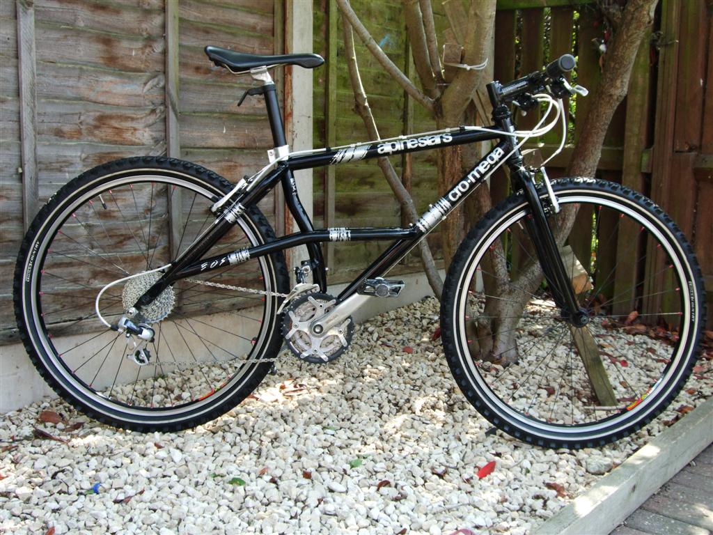

I thought it was about time that I posted a few pictures of my work in progress.
I bought BlackStar from Maverick a month or so back, and the poor thing hasn't turned a wheel in anger since she landed on my doorstep :(... I've decided to take a trip down the singlespeed route, and add a little splash of colour to her in the process...
The old wheels have now gone to a better home, and BlackStar's shiny new(ish) hoops now have pride of place on the lovely stealthy frame. The harsh lighting in my kitchen does the colour of the hubs no justice. They're a lovely deep pink colour 8)
The Flite Transalp has been swapped out for a NOS Alpes (bundled in with the wheels :)) and the XT M750 Vs have gone in favour of a more svelte set of M960s. Tyres are going to be Ritchey Z Max (remakes). Cranks will be XT M737s with a Middleburn 34T ring. I'm still on the hunt for some brake levers to finish the build off.
Here are a few pictures of how she looked when she came to me, and how she looks tonight (note - cable etc will be cut/tidied up!):
Then:
Now:
It's plenty beefy enough.. It's at a bit of an odd angle at the moment but that'll be sorted - I only got the wheels on this evening.

Funnily enough, I have thought about putting some coloured '91 Cro Mega decals on it (I prefer these to the '92 decals even though it's a '92 frame).
As for the singlespeed - well, most of my riding will be done on smooth(ish) trails, so there's no real need for gears. The combination of a tight SS chain and E-stays will make this bike as silent as a silent thing... Well, apart from the angry bee trapped in the CK freehub ;)
The other reason I went singlespeed is because I couldn't for the life of me get the gears to work properly. They worked up to a point, but the front mech was stretched to it's limits and wouldn't shift properly, and the rear mech just didn't get on with the cassette. I guess this is because the rear mech hanger doesn't hang straight down like a conventional one, which means that the rear mech doesn't sit properly under the cassette as it would normally. No, the mech hanger isn't bent - that's how it was!
