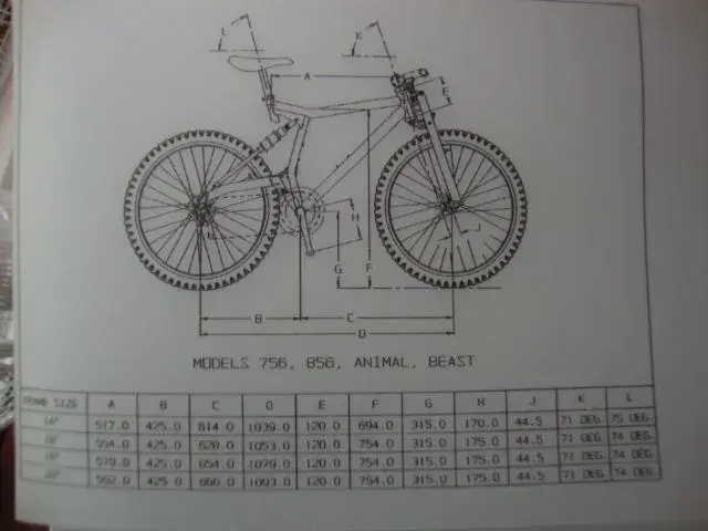

Proflex 856 sizing question.
sruss67
I am 170cm/5'7" in height.
Wondering if a large size Proflex 856 is too tall for me?
Apparantly the frame measures 18" to top of seat tube and Top Tube measures 58cm c-c.
This would be built up for offroad use.
Thoughts please.
Possibly a bit on the "Large" side :wink:
My 857 is Size Large, I'm 5'11" and have about 6" of seatpost sticking out the frame...
I'd probably go for a medium if I were you.
As a 6'1 856 rider of same said frame size (which runs large and fits me fine) I concur gents that for the op....
It's too big :shock:
Sorry buddy but they're right :(
My mate's 5'9 and he tried mine and didnt get on with it
proflex frames seem to size up oddly anyway. my old 18" felt more like a 20
I'm 5'7" and found a small 857 was too short along the top tube.
I also had a large xpx bought as a donor for the 857 and found it suited me far better.
The sloping top tube gives loads of clearance, it just means you have to cut the seat post short.
Ever tried a medium?
