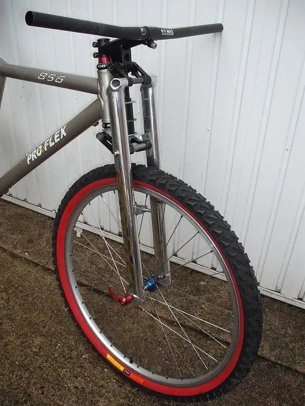

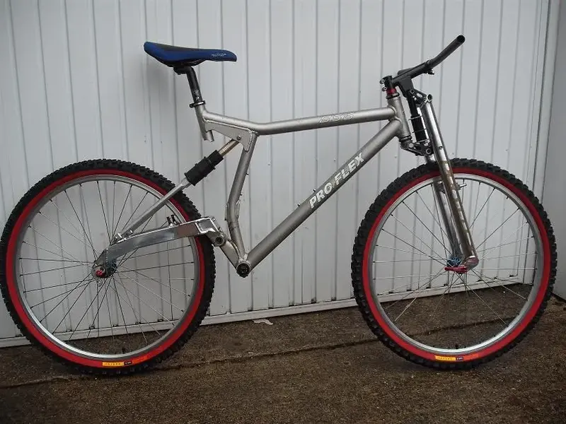

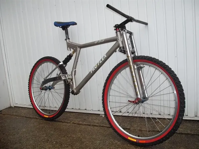

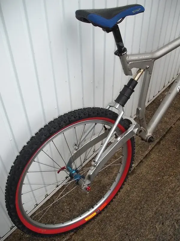

Ok few changes made to the Flex this weekend, Girvin forks now on and looking very good indeed. Cheers to 'MRGRUMPY' at 'Pauls Cycles' for sorting the insertion of the Chris King Thread-less Headset & Reducers. Top Job :D
Proflex Seat Post courtesy of evilbay measured and cut down, then DMR Saddle fitted.
Wheels have been changed for some Mavic/Hope glad in Duro Rubber which i had in the man cave.
Need some Flat bars, but the moment I've got my spare Orange HotRod bars, these are going to serve as a temporary measure.
Slowly but surely is coming together :)
