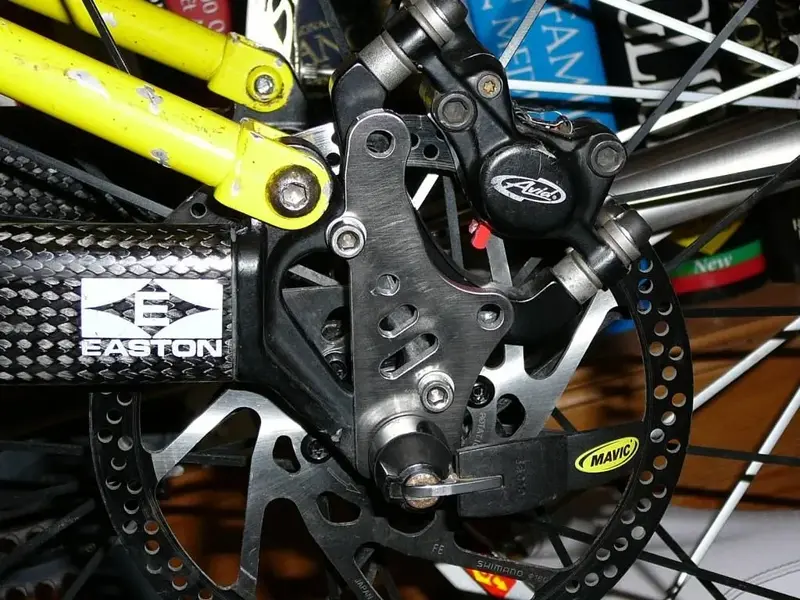

Now replaced the bodge...errr...modified DDG rear disc adapter with a Hammerhead designed for the job. Took ages to find one of these but worth doing as the mount is perfect and looks like its meant to be there, light too at 65g.

Looks a complicated but clever arrangement for the disc mount. Job done though! :)

Ah that rear disc mouny looks interesting, is it just a flat plate with cut outs?.

Yes its just a machined piece of flat metal about 4mm thick. Bolts into the dropout threads, pretty simple but works a treat. Was a little unsure the dropout is strong enough as its very cut away and then glued into the carbon swingarm but these have been well tried and tested - apparently ! No bigger than 160mm rotor recommended though but thats plenty big enough on the back.

I might see if I can make a disc mount, I am fond of a little bodgery.
