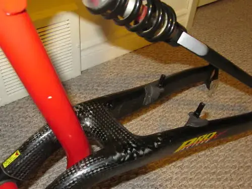

You're right about the swingarm being lacquered, most of the scratches that hold grease and crud, making it look tatty up close seem to be in the clear coat. I'll try to strip, polish and relacquer an inconspicuous spot and see how it turns out.

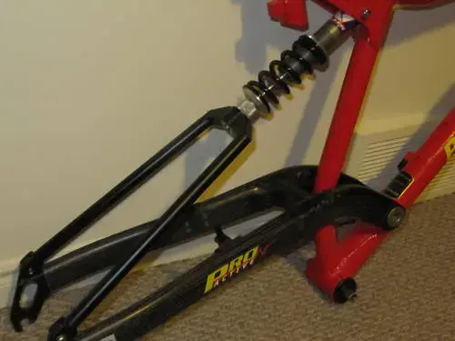

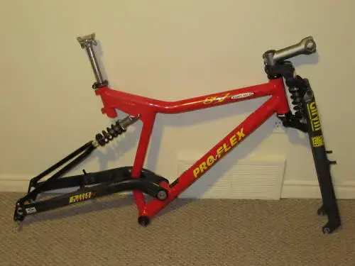

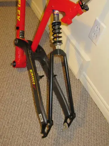

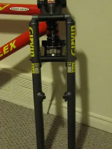

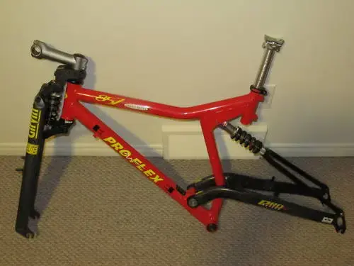

how's the build going? have you started assembly yet? any update pictures? here's my 857 that arrived this week. the frame and fork are mint. how these things sit around unused all this time i'll never understand. now i have to decide what components. i have a set of rolf rims in excellent condition i am going to use. same era but never came on this bike originally. but i'm not planning on building it original.
roy

hi
the only pictures i have are the sellers pictures. i haven't taken any myself. and i don't know how to resize to make acceptable for the site.
here is what i have.
roy

I think the frames with the carbon swing arm are really 8) 8)

I have a question though for fellow ProFlex owners - has anyone had the 856 style rear strut powder coated ?
It is made from 5 pieces and looks to be bonded, I was wondering how it would cope with the heat ? :? It's only under compression so so long as it doesn't fall apart in the oven I think it should be ok ?
