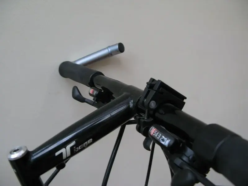

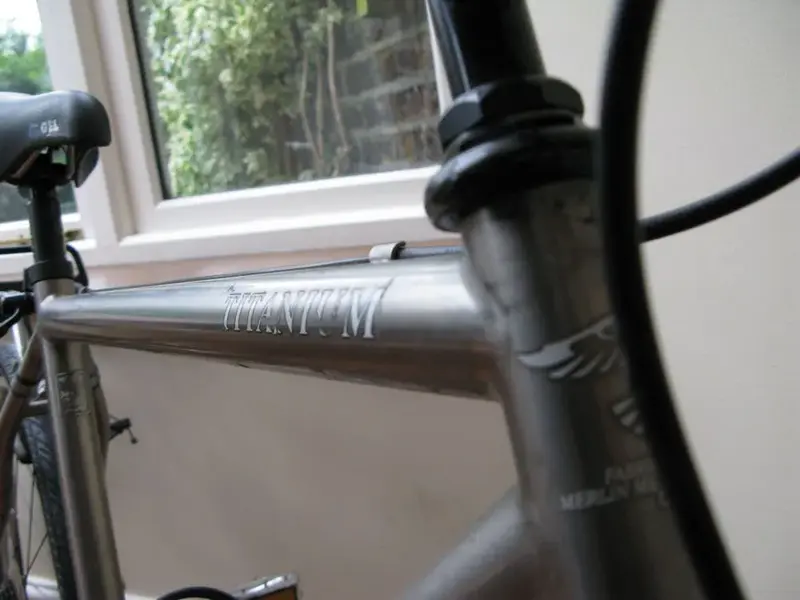

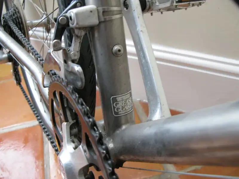

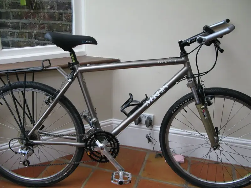

as a test to see if they hold air you can use a football adapter and a normal pump.
it's impossible to get decent pressure control but it does at least test if the seals are good
Bleedin' bike shops these days, somebody walks in with a proper Merlin & they can't even be bothered to help. Awsome bike BTW!
Used to have the Mag20's myself & remember having a problem when I pumped them up, I always ended up splitting the rubber valve where the 'needle' goes into the fork. Eventually I remembered to lube the needle (bit of saliva will do the trick) each time before inserting it into the fork.
A good tip that saved me lots of hassle with forks that wouldn't hold air & had to valves regularly replaced.
TSC.
IME a football adaptor is too big and ruins the seals. I'd not recommend it.
Nice Merlin, I thinks its a 'Mountain' but someone will confirm. Definately worth some effort to restore.
