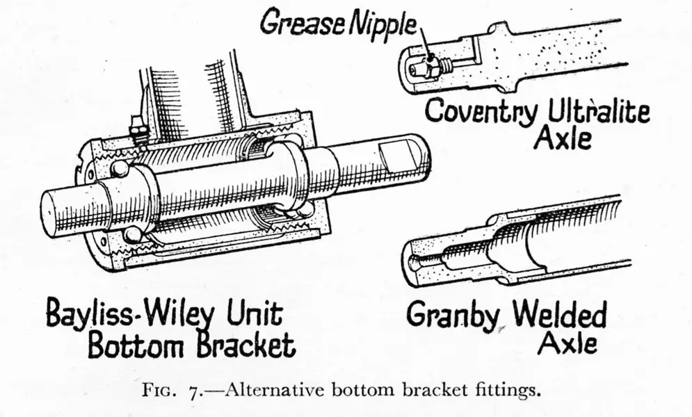

Is it one of these?

It looks like the Bayliss Wiley one. The fixed cup side just pushed into the shell . What holds it in place? other than the left hand adjuster cup?
Another of my bikes also has a similar shell with a bolt that goes through the bottom of the b/b shell and just into the sleeve there by holding it in place . This one does not appear to have one . I will flip the bike up side down and have another look.
