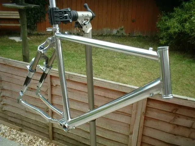

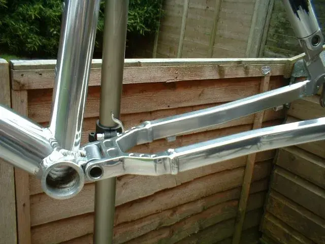

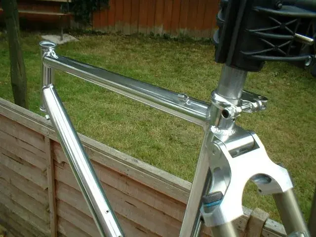

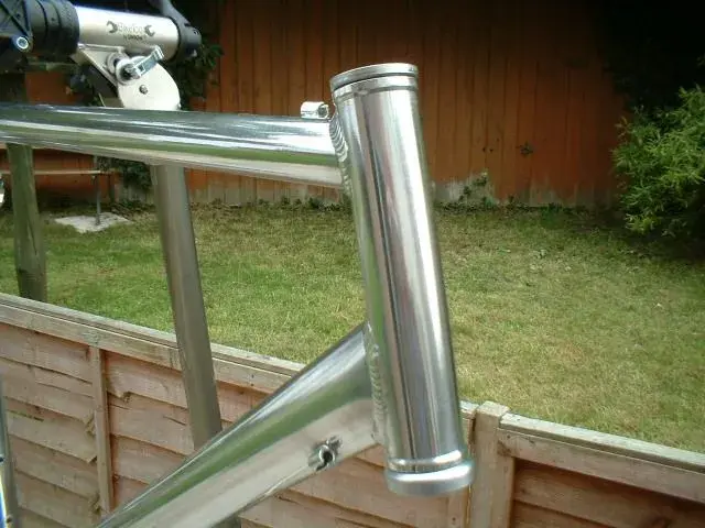

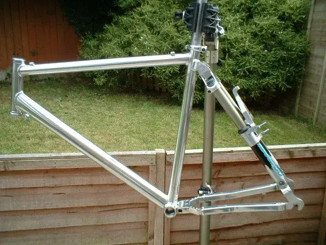

Well guys the result of my brainwave , and some seriously tired arms
gave it a good going over with the sander and scotchbrite pad , then a polish with good old autosol using a long rag and the " MILKMAID" technique :lol:
and a final buff with some brasso ..... the result =
:shock:

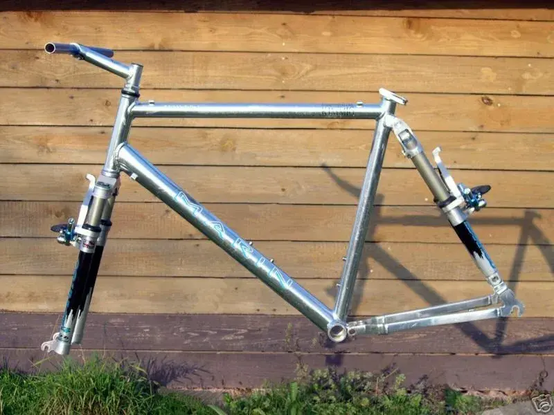

How bad was it before you started? Any pitting or corrosion?
Just a shame it always oxidises so quickly :cry:
the frame itself wasn`t too bad but the lacquer was really bad
so had to remove that , going to get it relacquered if i can before it does oxidise again
if you look at the seatube in this pic , it was like that more or less all over
