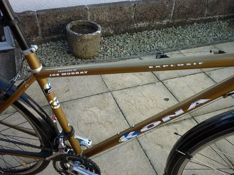

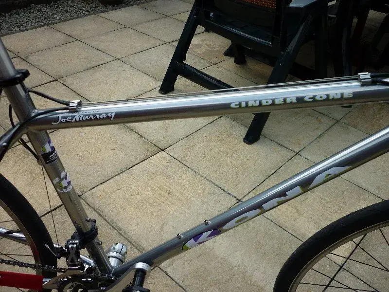

A few pics:
Wet paint, decals, clear coat:
Powdercoat, decals, no clear coat:
My Clockwork has just the decals applied to the powder coat. Looks fine to me and as others have said it'll be easy to replace them if they get damaged. Decals were from Gil. :wink:
