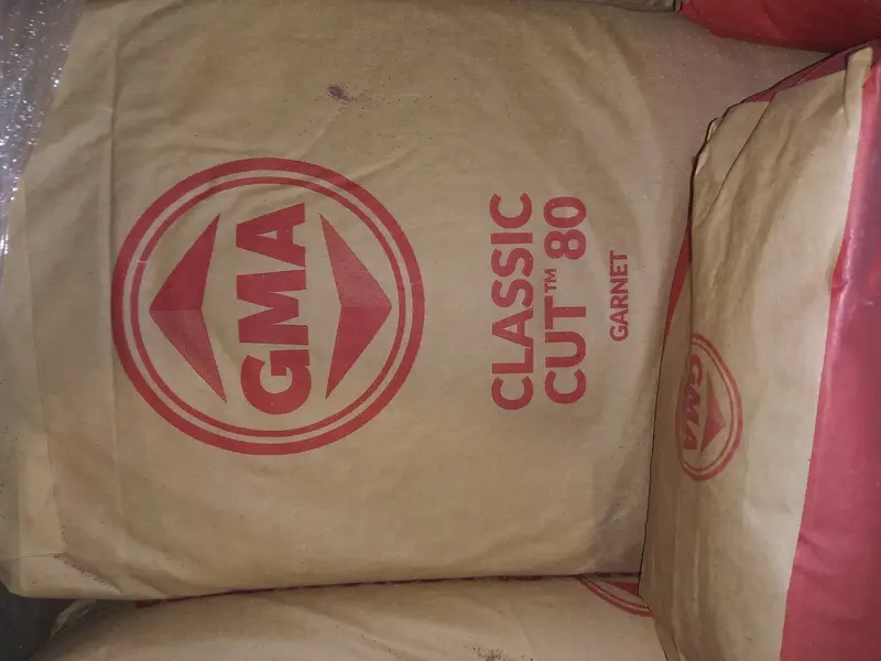

Exactly, the testing I did was to work out the effects (positive and negative) of various media/pressure/nozzles/patterns on different materials and masking material. So we ended up with curves to follow, what media and what pressure, to maximize cleanliness, minimize cycle time, minimize damage.

I can't hope to be as thorough as mattr, so I will save my energy and defer to his recollections
