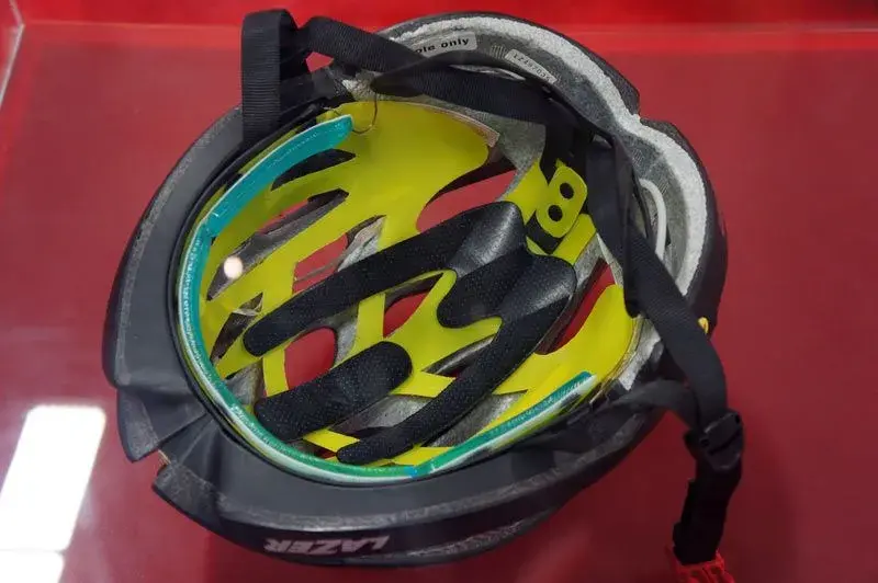

That's the principle behind the Swedish MIPS system. A low friction plastic lining between the helmet and the head. If they have got the engineering it may prevent the helmet from gripping the head but it only allows for about 15mm of movement before the chin straps or plastic lining retaining bands will prevent it from moving further. I can't see how this would be enough to do much good.
You can get helmet rain covers. I wonder these would help to stop the helmet from gripping a road surface etc.
Someone should be lab testing ideas like this. Or maybe they could use crash test dummies for even more realistic results?
