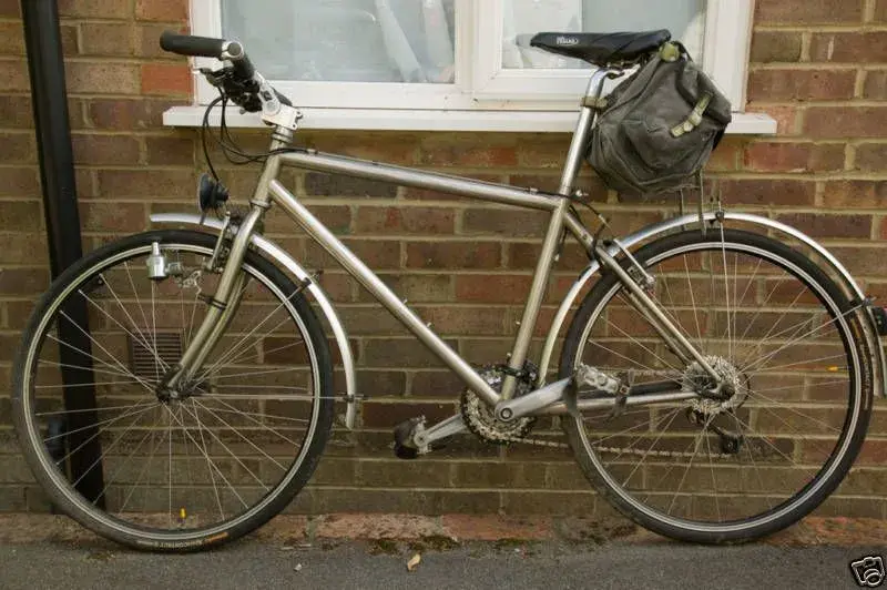

I would say it's a Merlin TDB (which stands for Tange double-butted). The Ritchey dropouts and wishbone stays are consistent, and it looks quite like the example below, which was advertised on eBay a few years ago.
I don't know which (Taiwanese) factory is 'S', but 9708 tells you the date of manufacture was August 97, so it's a 1997 or 98 model. Some VooDoos of around that time have S serials, but in a slightly different format.
I presume the tubeset is Tange MTB, i.e., double-butted, but not heat-treated like the Merlin WCS (which was made of Ritchey WSC, i.e., Ritchey's reworked version of Tange Prestige). It was Merlin's basic steel frame, sold for £135, whereas the WCS was £200. I haven't seen a review of one, but the Total Bike review of a WCS was 5*, best of test, and this presumably shares the same geometry at a slightly greater weight.
