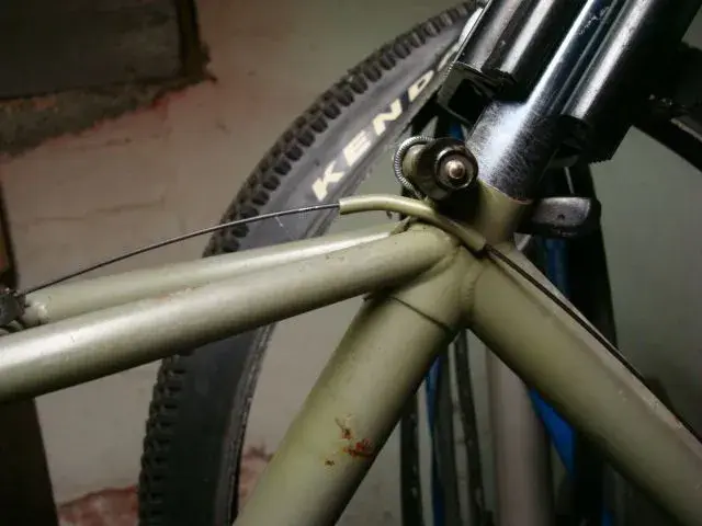

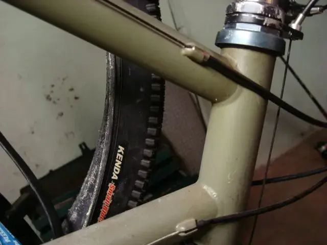

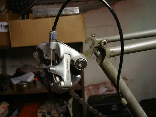

Need help identifying the year and model of this Gary Fisher pre Trek rigid mountain bike. Serial # FS 91012860 The only original parts on the bike is the Tange evolution 1 1/4 superlight headset. it originally had the roller cam stem. NO u-brake, has dia compe cantis. Ritchey/Breezer dropouts. Press fit btm bracket
Original paint was a yellow fork/forest green frame.
please see pics for unique features... like the steel noodle welded to the seat post collar for the rear canti. :) thanks in advance for your help

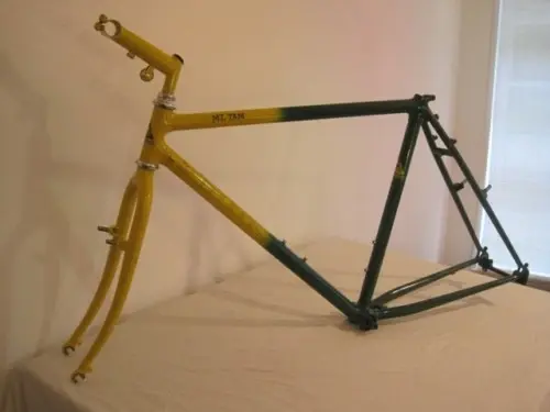

its a gary fisher Mt Tam says a man who has too much time on his hands today :wink: 86-88 ish says google and stumpjumper on an old thread
don't think it's a mt Tam... those are filet brazed right ? :shock: were there early versions that were not ? everything else looks right.

#### This frame has canti mounts no ubrake like the mt Tam pictured also, rear drops appear to be brazed/// but wtf do I kno

NO UBRAKE Breezer dropouts, tig welded frame, reinforced seat collar with noodle for rear canti, brazed rear breezer dropouts.
NOT a Mt Tam
My frame has different dropouts, different reinforced seatpost configuration,
different frame geometry than ANY year Mt Tam I have ever seen.. I am disappointed that I can't get help here identifying year and model. It's def not a mt tam... that's for sure
