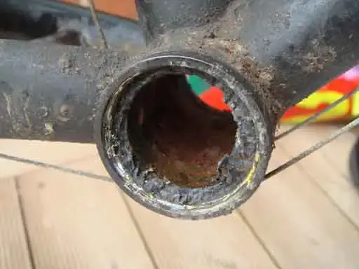

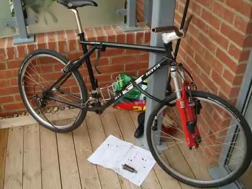

Thanks for your help guys - I've tried to attach a picture of what I'm left with - what a bloody mess! I've also attached a picture of the bike so you can see what I'm trying to save...
What I want to do is hit it out with a blunt screwdriver - but I'll mash the threads.
Any suggestions appreciated!

Melt
U got the BB out then? A blow torch looks the next stage :D A trip to the local Powder coaters next for a glass bead strip then re coat to deal with the rusty bits.
Yes I did thanks. I was pretty pleased when it started to move! Which quickly turned to anger as the other side turned to swiss cheese.
What's a glass bead strip then? Does anybody think I get get it out without destroying the paint with a blowtorch???
