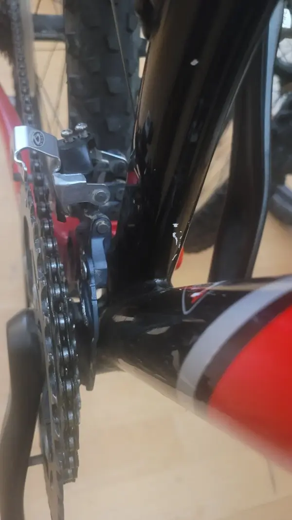

I have a 2002 Shimano Deore LX Rapidfire SL. The problem is unlike derailleurs from recent times, this derailleur cannot be adjusted up and down. It's just straight bolted into the bike.
So the chain keeps hitting it, but since I can't adjust it up and down, I don't know what to do. I've taken to couple bike shops but they say they havent seen this kind of retro derailleur.
I'm wondering if I need to just replace the whole thing or if there is still a way I can adjust thing thing. Any comments or insights is appreciated.

Does it move out you pull (sideways) on the cable directly above it?
Is it bent? Have you tried drenching it in penetrating oil?

Hi, thank you for replying. No, it is not bent. And no, it does not move out.
I have not drenched it in oil as I'm not sure what the purpose of that would be...?
The issue is that the cage is in the way of the chain, so I just wanted the derailleur cage to move down a little. But again there's no up/down adjustment. Just straight bolted to the bike.:confused: The bike itself is a 2002 StumpJumper XC, btw.
I think that's called an E-type fr der. Not valuable like an E-type Jaguar sadly, it is mounted within the bb cup & frame. I don't think there is adjustment, if any it is if you can give it some small rotation within the bb cup. So crank off & bb loosened to adjust (if any).
Replacing it with a conventional choice would make sense & should be relatively cheap to source a matching 2002 mech. This design of E-type fr der is not very versatile with alternative cranks or bigger chainrings etc. It is flawed.

Some e-type front mechs adjust with alternate mounting holes on the bracket interface but I don't think the LX had that facility.
I can grab some photos of the alternative e-type's if interested or as above you can just remove and swap for a conventional mech (although you might have to add a bb spacer if you have an e-type specific bb).

OK, so what's wrong is that the E-type mech has rotated clockwise, so the bottom of the cage fouls the chain.
Remove the chainset, undo the bottom bracket (clockwise) about half a turn. Reposition the mech anticlockwise and retighten the bottom bracket.
If you want a replacement front mech, you will need a top pull one. Measure the seat tube diameter (as it's aluminium, I bet it's 34.9mm) and that gives you the clamp size. So you need to search for a 34,9mm (probably) top pull 9 speed triple front derailleur.

There doesn't seem to be any reason for an e-type mech on that frame. Go for a clamp on one, if your drive train is lx, why not match it.
