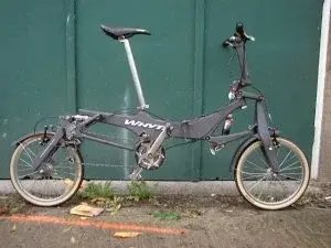

Rear mech is awfully close to the ground, though. Use a breakaway bolt!
Too bad they don't get the mech up out of harm's way like this clever Whyte.
The Burro's a bike where a Rohloff would make a lot of sense.

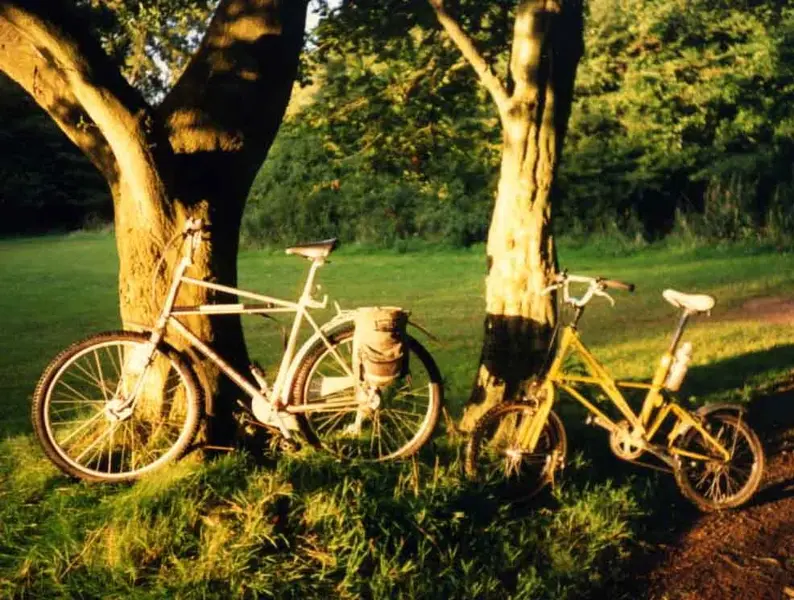

Big wheel v Little wheel
These two bikes, both from 1988, show that the big wheel / small wheel ATB debate is nothing new.
The Moulton ATB is strong, accelerates quickly, and is multi-purpose.
The Highpath made Cleland, is designed for riding over soft rough ground with the minimum rolling resistance. It's large 650B x 2 inch tyres run at very low presure, are its secret.
On soft ground the Cleland is fast and efficient and the Moulton slow, as it digs a small trench as it moves. This feels like you're towing a plough behind the bike.
On smooth, hard ground, the Moulton is faster. It's perfect for road use with the occaisional off-road section. You do need to look out for wheel sized holes though.
In theory small wheels should not be as good for hill climbing as large ones. This is because there is a force vector from the rear axle (fixed point from the ground) that pushes against the centre of mass of the machine and rider. The steeper this vector the smaller the proportion of the total pedalling energy is actualy pushing the bike & rider up the hill. The remaining vertical component of the vector will then cause the front wheel to lift more easilly than with a large wheeled bike in the same gear.
Small wheels are of course inherently stronger and so can be made lighter.
