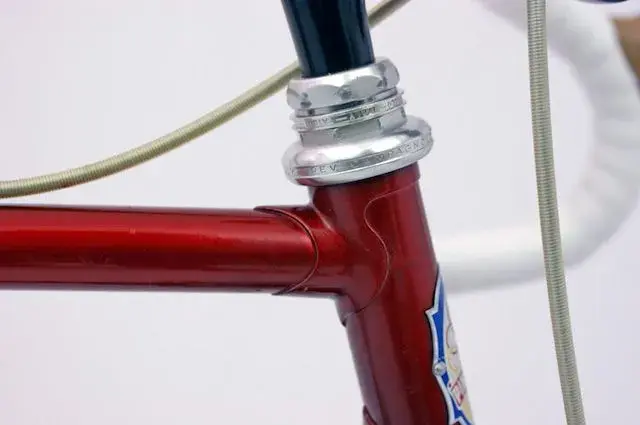

@Midlife, I wish! But no, I’m the original owner and the frame was painted in a colour listed as “Red” on the sales bill and “Bordeaux” in the 1985 Pinarello catalogue. In a 1989 Pina colour chart, a similar colour is listed as “Trasp. Metallizzati Rosso” (transparent metallic red). A good example is the bike below (not mine).
My guess is thats a flamboyant or tinted laquer over polished zinc..... unless some chrome was visable, ie drop-outs etc, there's not much point in chroming if it will all be covered in paint.
If you get the top tube replaced and intend on repainting as is, you will have to get it re-zinced and polished. great rust proofing afterall.
